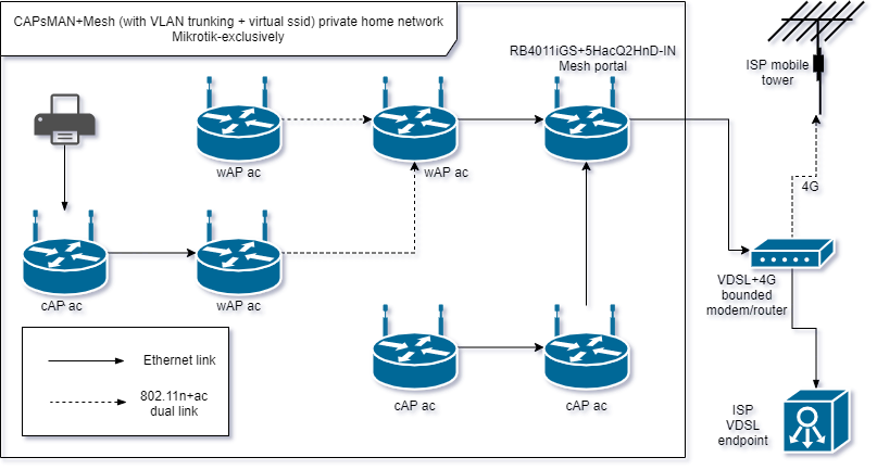

Hello, strangely there aren’t many resources on how to make Mikrotik mesh networks. I use RouterOS6.48.3. I have many wAPac and cAPac, but currently I tried basic mesh with one portal and one node.
I have tried this tutorial:
https://help.mikrotik.com/docs/pages/viewpage.action?pageId=8978441
Connection between 2 nodes is ethernet type (mesh port). Full network will contain WDS and Ethernet links.
Currently each node recognized each other as “outsider”, how can I make them “neighbors” ?
Network model I am trying to establish using Mesh:
