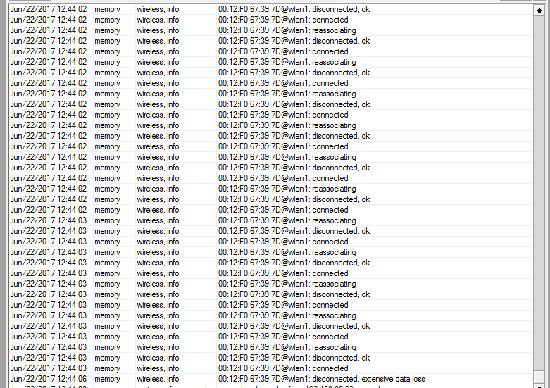

I did enable wireless debug in logging and watched what happened when trying to connect with the Panasonics. I will attach a printscreen.

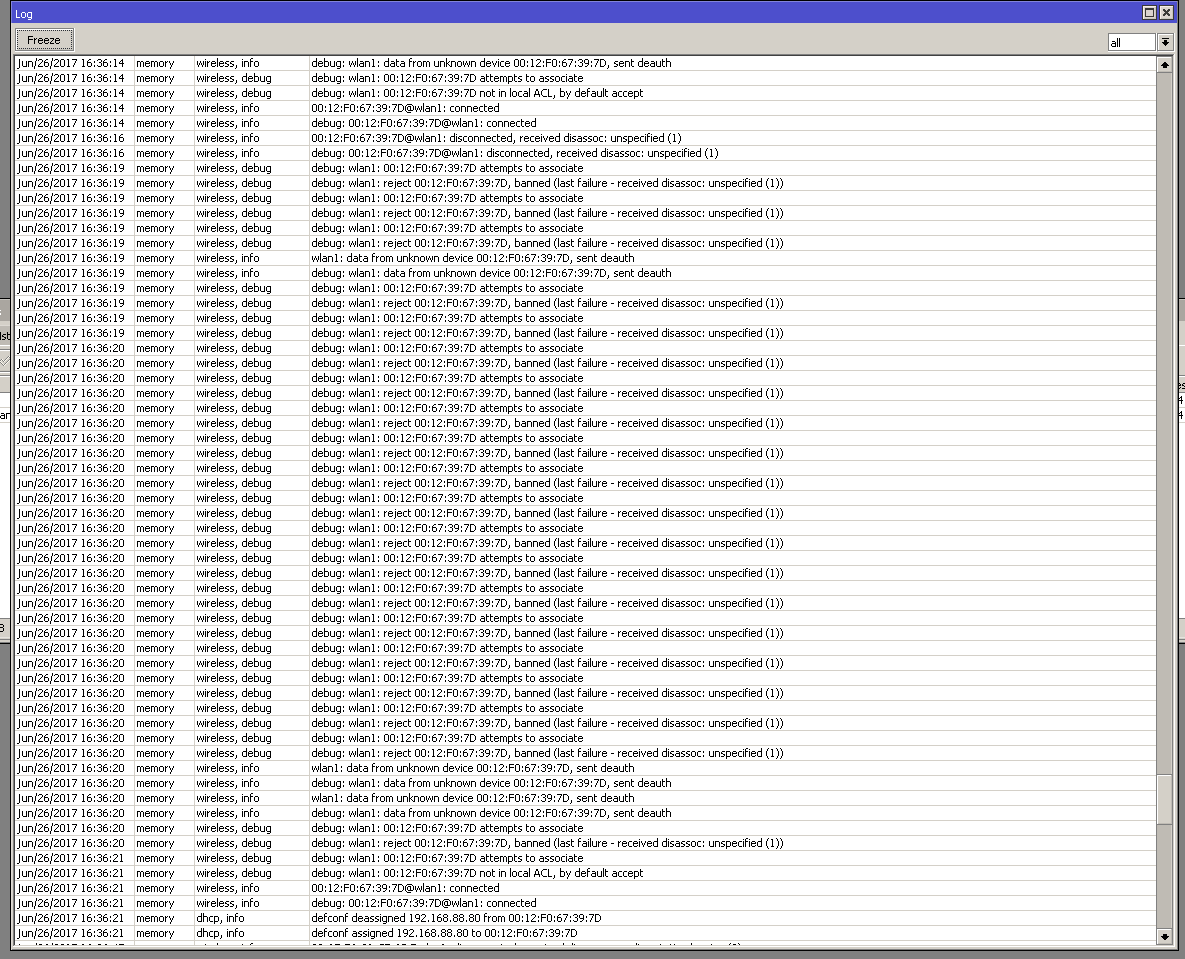

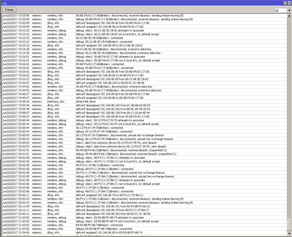

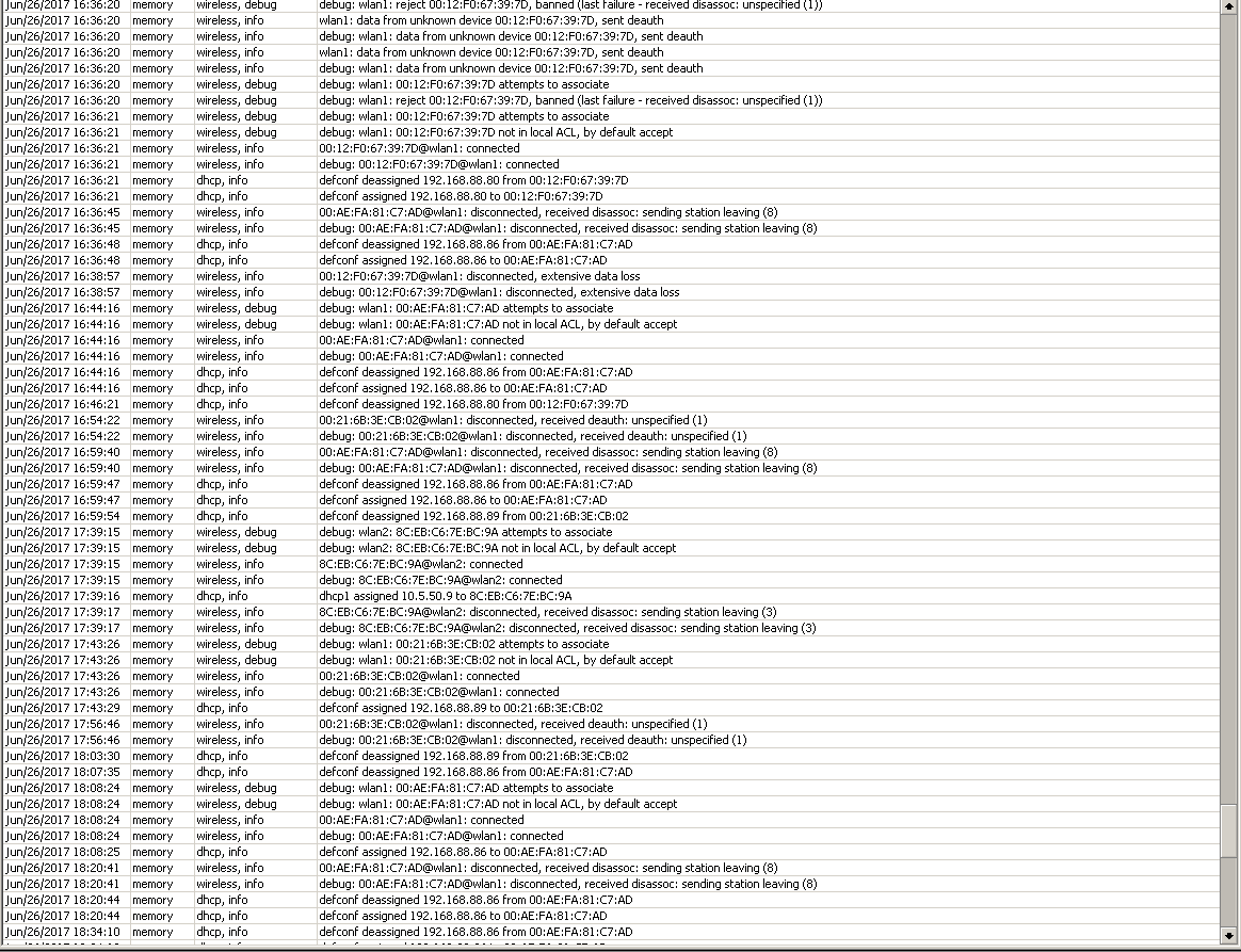

Ok so this is after updating to 6.39.2 and routerboard firmware 3.33, the log is very active and I see some “banned…?” messages there.
See attached screenshots of the log
