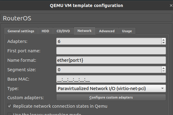

The issue is with your ROS template in GNS3.
Change the network interface section like this:
When selecting an interface to connect ether1 will still appear as ether0 in the GNS3 selector but labels will be fine.

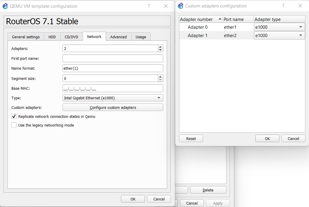

I don’t have that kind of Windows in my GNS3, but I found this Option:
But nothing changed, even if I deploy new Mikrotik VM devices in my project
In the configuration template, use this values:
It works now, even though the new setup works just for the new devices. The old ones in my project are not affected by the template modification.
Thank you
