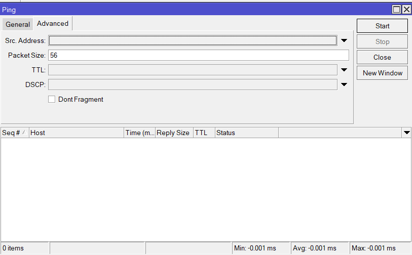

That is why the ping screen has the ability to select the source IP … same problem it’s a guess what IP the tik will choose to ping from.

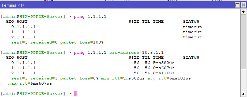

As I said why do you think ping contains the option for source IP .. something you never have to use because the tik guesses right for you.
Here is a transit router see it has no idea where 1.1.1.1 is unless I give it a source IP. So in this case the private local IP will NAT to a public IP and then it can reach 1.1.1.1
So because I can’t set the source IP for the local DNS server I can’t use it or I have to do hijinx with mangle. The internet in this case is 3 hops away.
