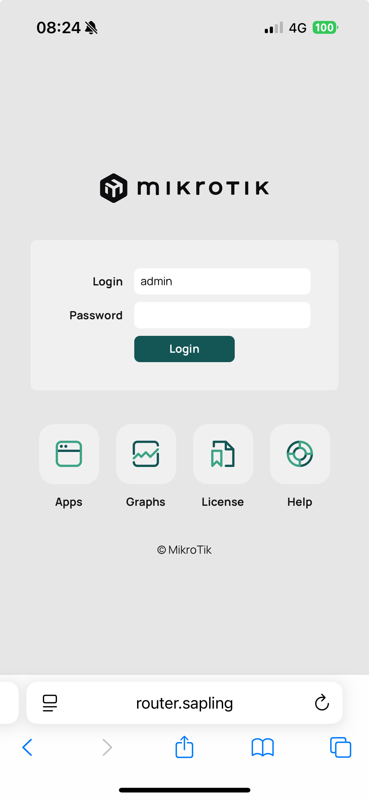

From the iOS device I can connect to the Mikrotik web interface using IP address and the domain name:

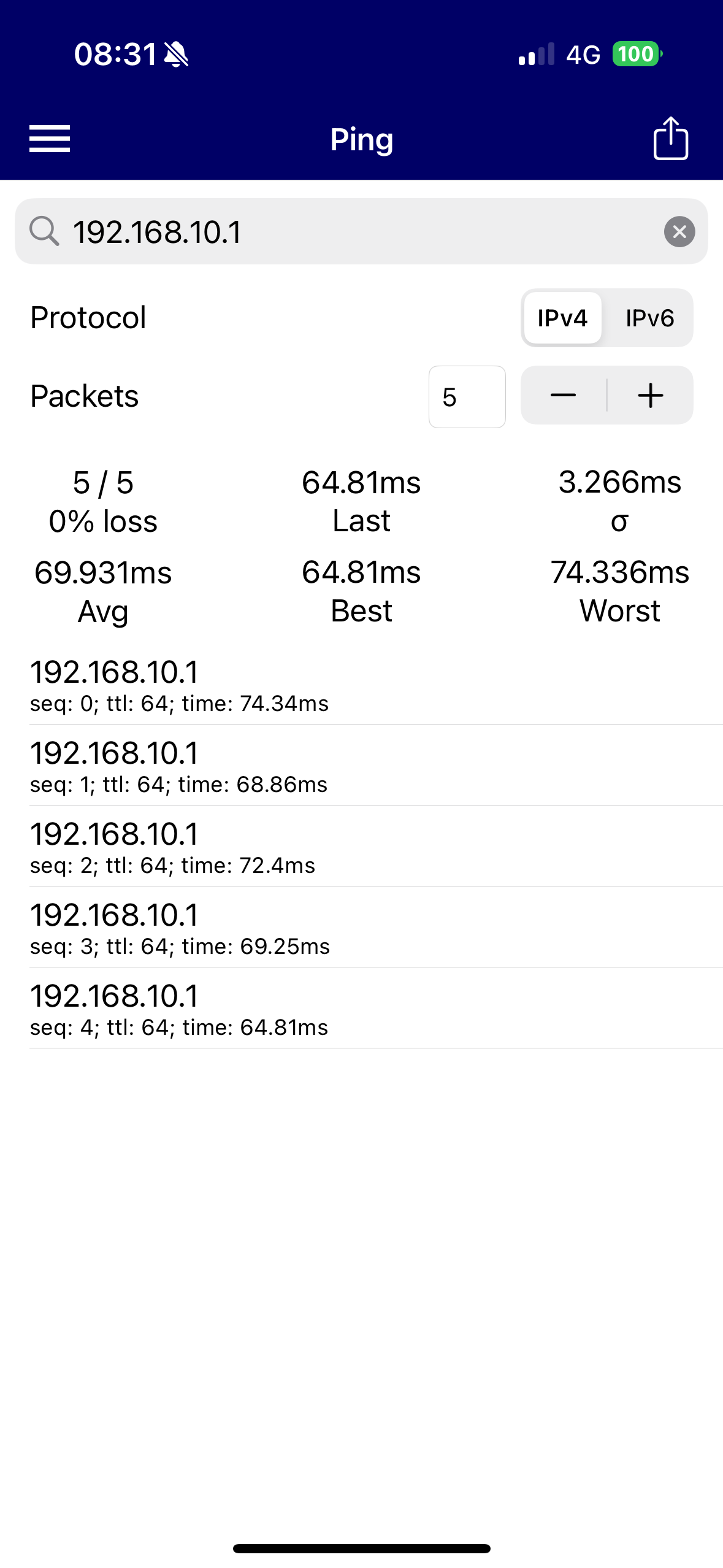

Using the “Network Tools” app on iOS I can successfully ping the Mikrotik interface using IP and domain name without issue and see all ICMP packets via Wireshark streaming from the Mikrotik:

  • I can ping my IPv4 edge Mikrotik router interface - 192.168.10.1

  • I can connect to my edge Mikrotik router interface via the Mikrotik app via router.sapling (resolves to 192.168.10.1 via NextDNS for my LAN)

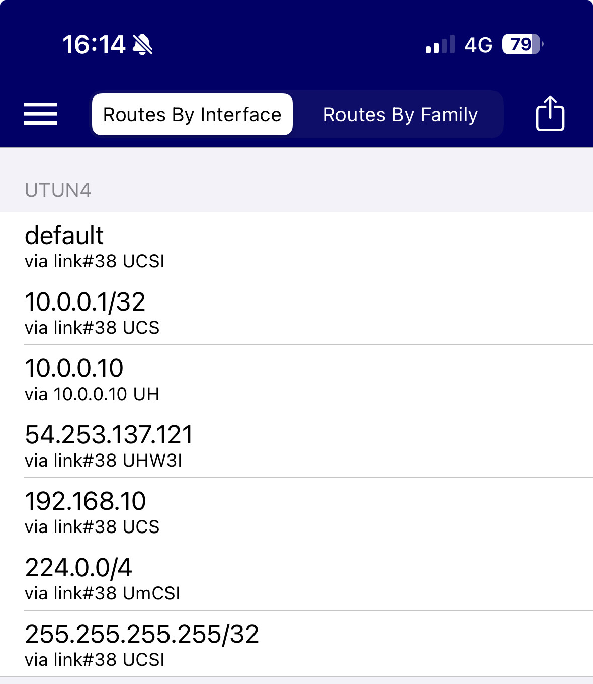

UTUN4 route on iOS device when Wireguard is connected:

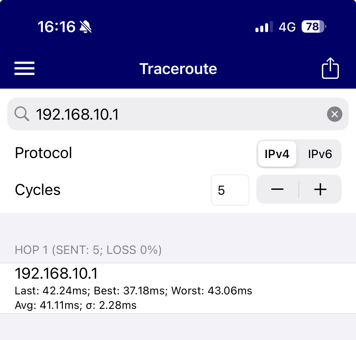

And a trace route from the iOS device showing one hop to 192.168.10.1:

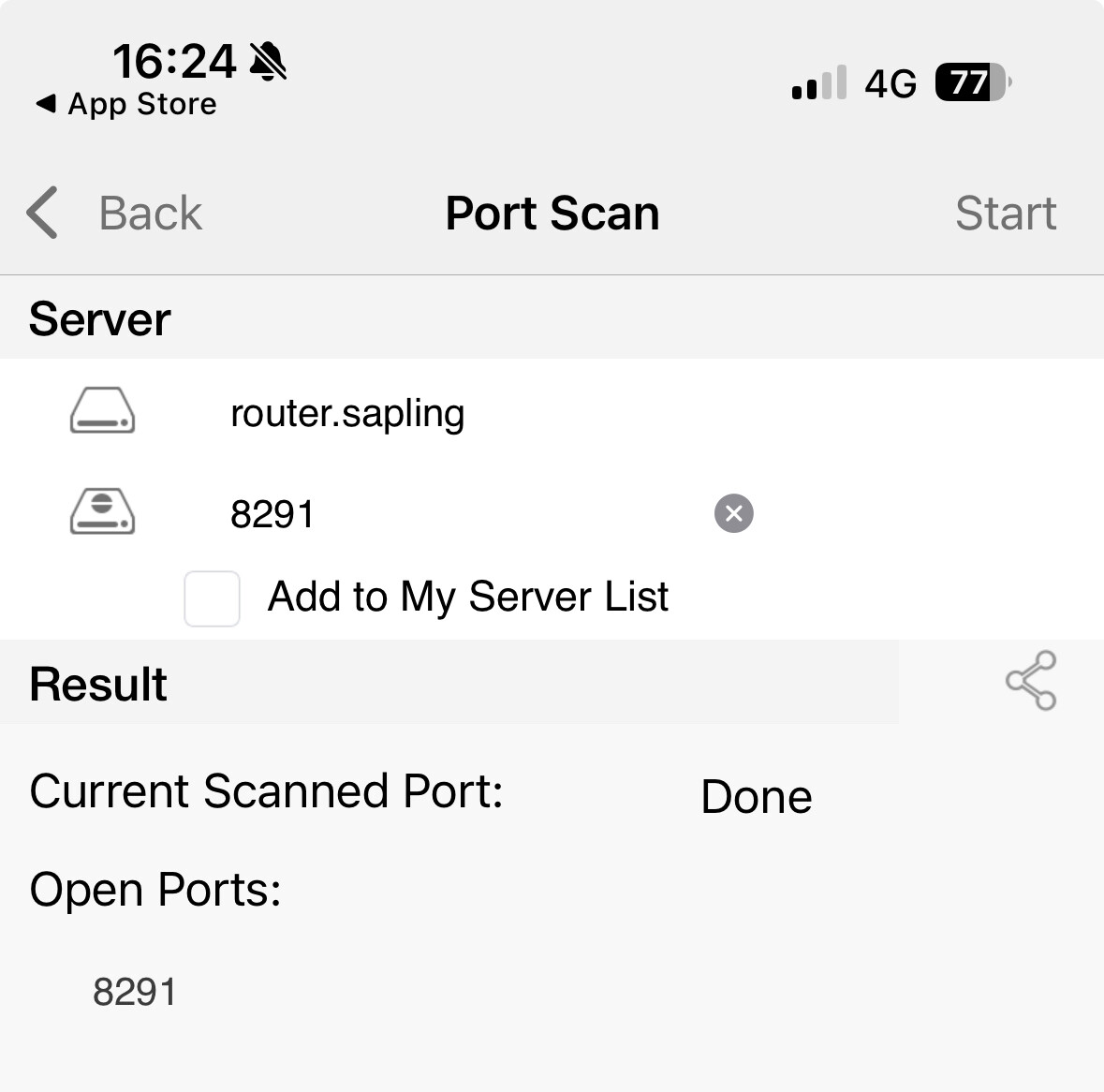

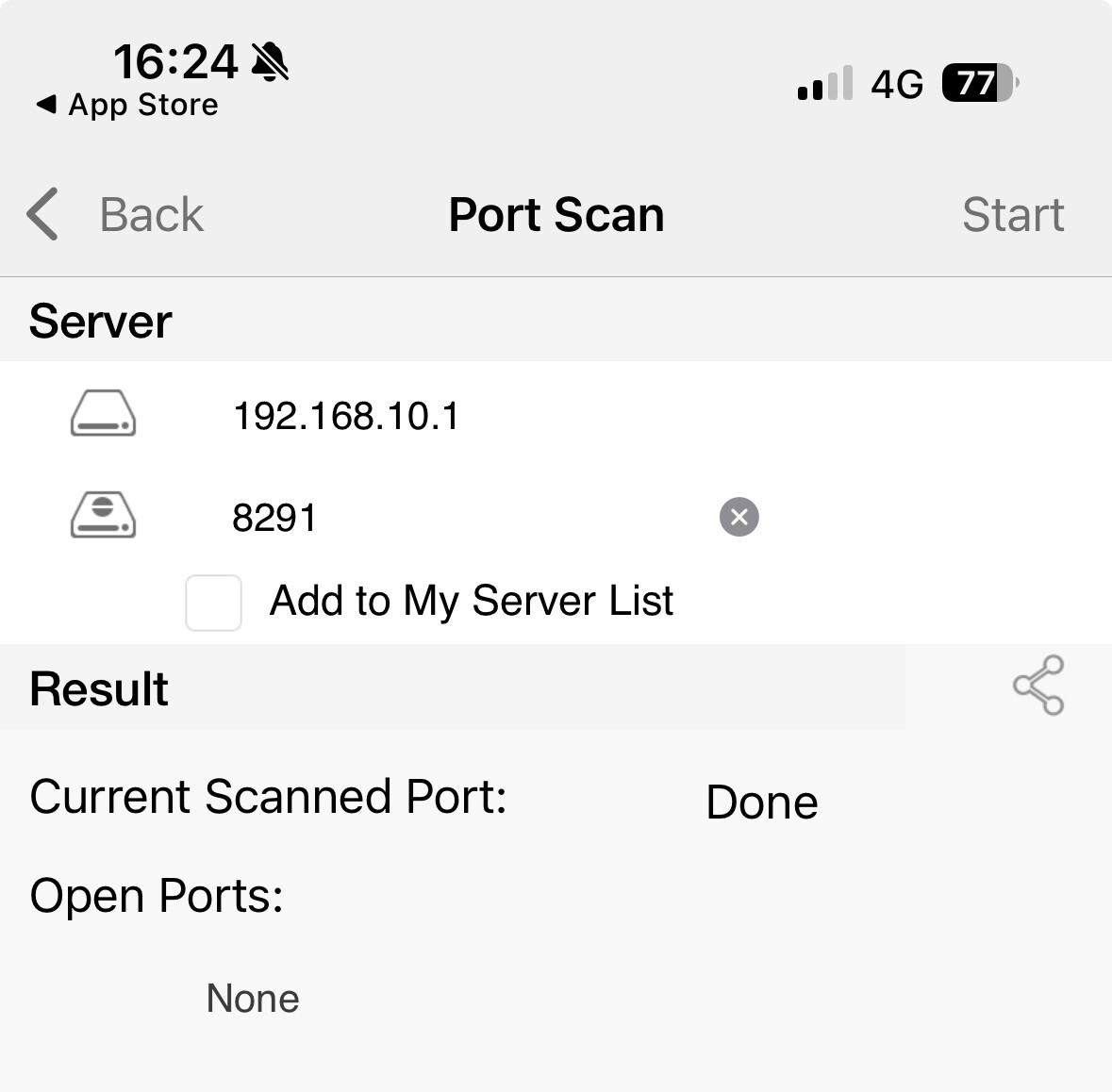

So this gets stranger… I found another iOS app that allows a port scan to a specific address. When I port scan to the name router.sapling on port 8291 it succeeds, if I use 192.168.10.1 to 8291 it fails.
FAIL:
SUCCESS:
