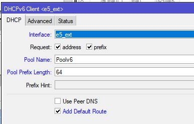

In the dhcpv6 client, you need to “Request:” both the address and prefix, so both checkboxes.
Also give a name to the pool.
Depending what pool prefix you want 1 network (or more), set Pool Prefix Length: 64 (one internal ipv6 network) or less.
don’t check dns, ipv4 dns is enough.
and add route
Then you can use that pool by name to assign ipv6 to your lan.
And finally configure the nd to announce internal range:
PS: you can ommit the MTU=1480, as you have native full size packets
The problem is that when i check the box “prefix” i don’t get anything with ipv6 dhcp-client.
I’m a command line guy, so here’s another way to look at it (with my omission paranoia):
[me@MikroTik] /ipv6 dhcp-client> print detail
Flags: D - dynamic, X - disabled, I - invalid
 0    interface=ether1 status=bound duid="0x(long hex string)”
      dhcp-server-v6=fe80::stuff:1 request=address,prefix
      add-default-route=yes use-peer-dns=yes pool-name="ipv6-prefix"
      pool-prefix-length=64 prefix-hint=::/56
      prefix=2600:stuff:stuff:stuff::/56, 19h40m13s
      address=2600:stuff:stuff:stuff:stuff:stuff:3494, 19h40m13s
[me@MikroTik] /ipv6 address> export
(stuff omitted)
add address=::1 from-pool=ipv6-prefix interface=ether2 <— internal interface (the rest of the options are default)
Maybe one of the things you are doing by checking “prefix” is something your ISP is warning you about, but I kinda doubt it. They should be handing you at least 1 ::/64 prefix.
