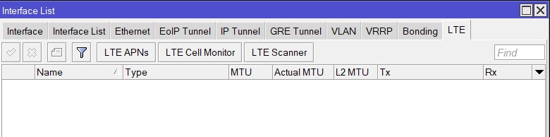

Mikrotik KNOT (RB924i-2nD-BT5&BG77). I tried on RouterOS 6.48.3, 6.49beta54, 7.1beta6.
The LTE interface doesn’t work, it’s not listed as an interface. There is a ppp-out1 interface (Type: PPP Client).

As you can see the LTE-M connection (That is NOT the same as the traditional LTE), is managed by PPP interface. On summary, KNOT doesn’t have any LTE interface.
Regards.

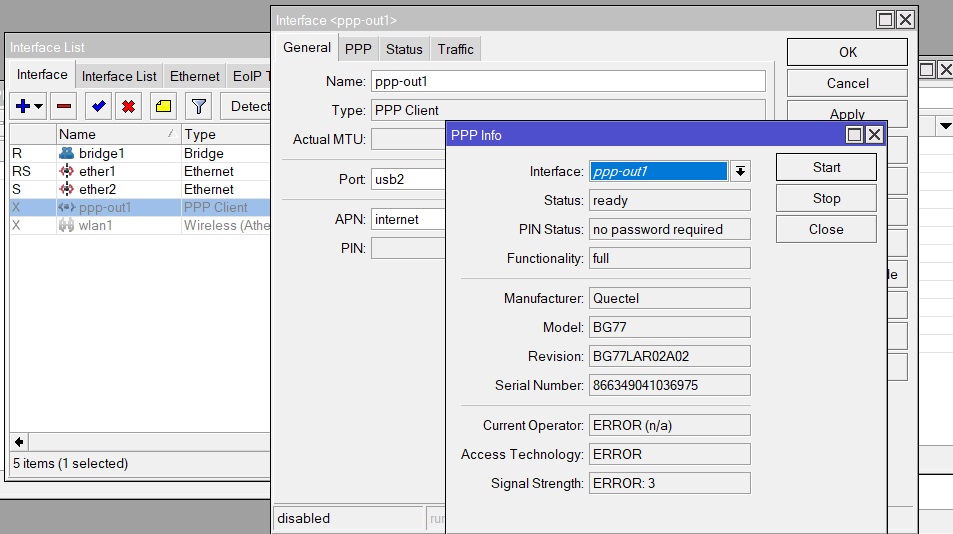

Here is a screenshot of the Info from the ppp-out1 interface. There are 3 errors after the serial number.

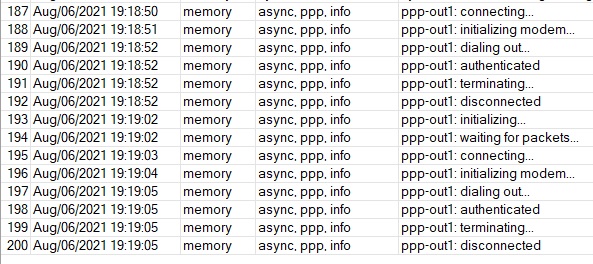

Here is a fragment of the logs after enabling the ppp-out1 interface.
How to fix these errors?
LTE plans and LTE-M plans are diferent. Make sure that your ISP support LTE-M technology. Probably you are trying to use regular LTE technology on a device that only support LTE-M technology. These technologies are different.

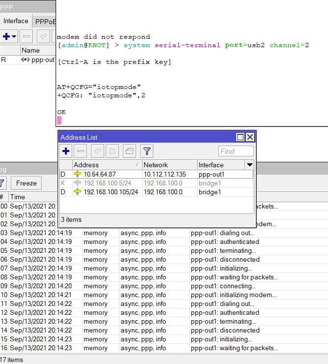

LTE-M is completely different to NB-IoT. I don’t know what the commands Mikrotik issue to the BG77 modem but AT+QCFG=“iotopmode” specifies if the module should support eMTC / LTE Cat-M1 (mode=0), NB-IoT (mode=1), or both technologies (mode=2).

KNOT supports NB-IOT and Cat-M - mode = 2.
It gets an IP address. But when I run a ping through this interface the interface disconnects and reconnects.
