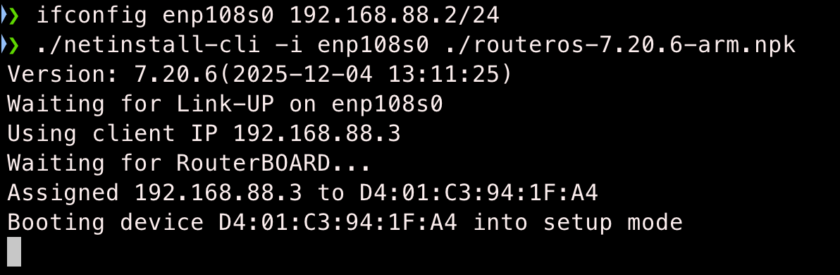

unfortunately - netinstall did not work …

Did you hold the reset button long enough to trigger netinstall?
What is the behaviour at this step of your router ?
From what we see Netinstall did work, if it stuck here, then this is the file transfer part that fails, but first netinstall (PXE) polling from the routeur to search a Netinstall server did work (last line shown), the minimalist system has been sent to the router…
If it stays here, maybe your storage is in a bad state :frowning:
At least, RouterBOOT seems to be OK, which is a good new
Also, did you try to launch netinstall with both bootloaders ? Try to netinstall by pressing the reset button just after powering on to trigger main bootloader, and if it doesn’t work, press the reset button before powering on,
Hope it will work,

i tried both - with no success …
the router just stays there forever - only the BLUE LED is on after i release the the reset button (of course the green one was one, flashed a couple of times and went stable again, then turned off)
not even the LEDs above each ethernet port flashes or light up during boot :frowning:

You can try a complete reformat of the flash (or NAND on L009 ?) from RouterBOOT, that still seems to work as the router searched for Netinstall server (last picture)
