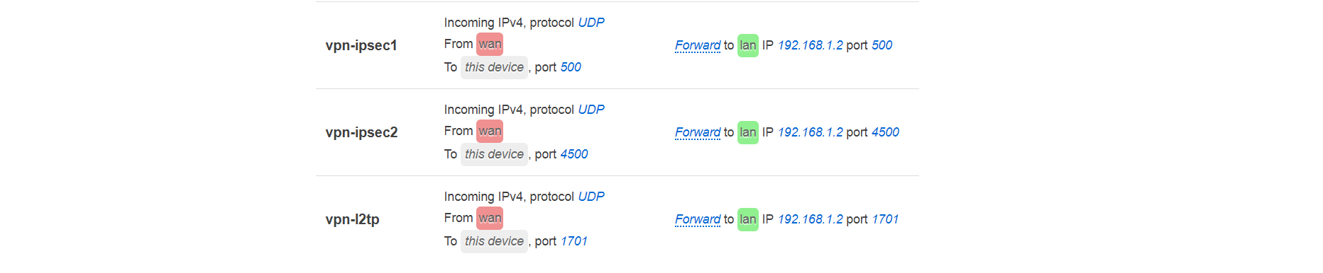

Openwrt firewall rules are untouched, with only these port forward rules added for the mikrotik vpn server:
