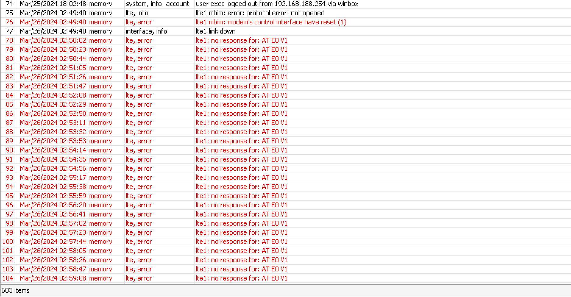

I have the same LHGG LTE18, and since the 7.14.1 update mine has started to become unresponsive when trying to access it via a browser at 192.168.188.1 . Using Winbox, however, does work. Strangely, it lost the LTE interface and provided errors throughout the night!
LTE firmware is also up to date.
Hmm. The fact only winbox works is strange here. Since that shouldn’t have anything to do with LTE not working right.
