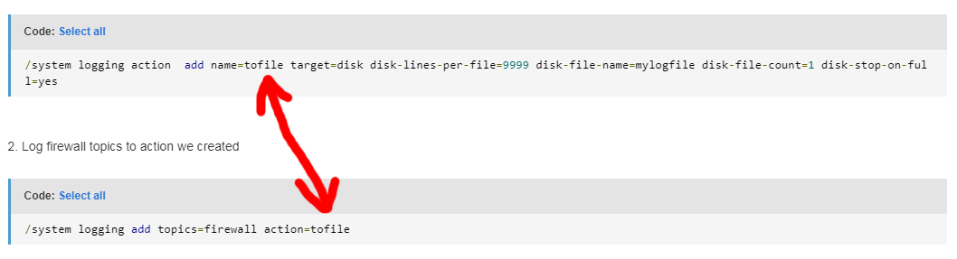

But a simple setup would be like this:
1 Setup a logging action
maximum lines of log file will be 9999
only one file will be created
if file is full will stop
/system logging action  add name=tofile target=disk disk-lines-per-file=9999 disk-file-name=mylogfile disk-file-count=1 disk-stop-on-full=yes
  1. Log firewall topics to action we created
/system logging add topics=firewall action=tofile
  1. Setup firewall filer rules to log new tcp and udp connections. In src-address the network or ip’s we want to monitor
/ip firewall filter add chain=forward src-address=192.168.88.0/24 protocol=tcp connection-state=new action=log
/ip firewall filter add chain=forward src-address=192.168.88.0/24 protocol=udp connection-state=new action=log

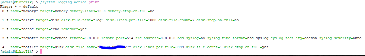

file should be created automatically under mikrotik files and you shouldn’t see it work on system log. probably log action has not been created successfully and and you are logging to memory instead.
see if logging action have been created by print command
/system logging action print

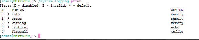

and if logging rule action match with the name of the action you created
/system logging print

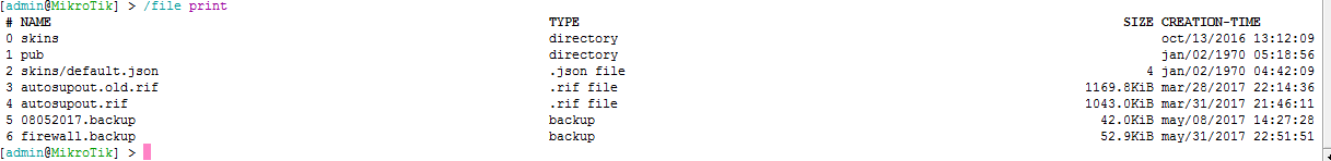

so how can i see the file ?
/file print
or if u use winbox go to files use drag and drop file to desktop
this is my problem file does’t exist

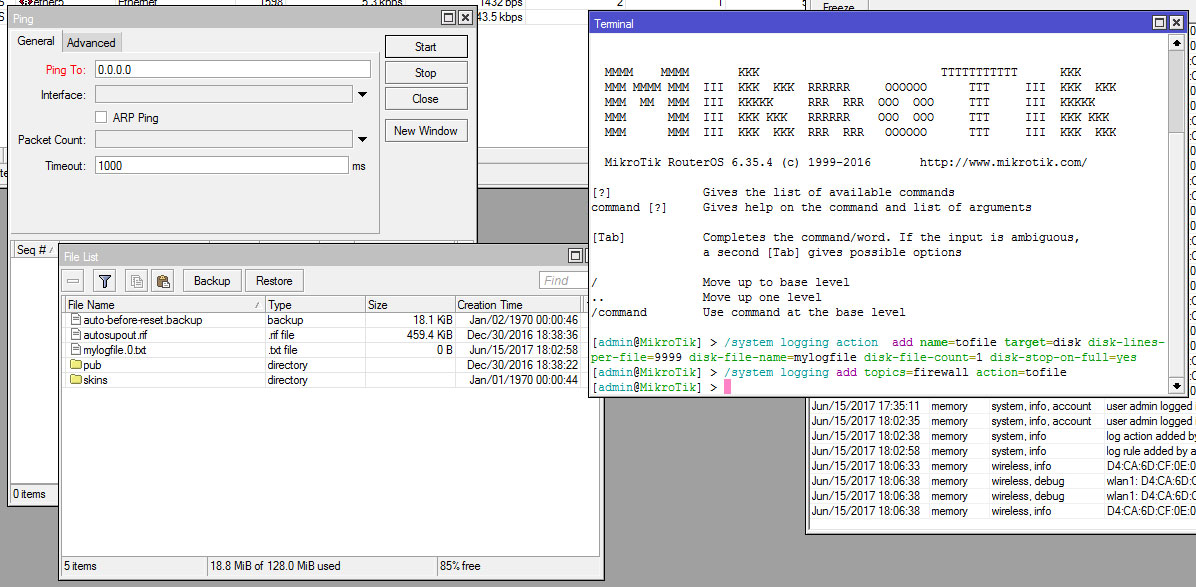

i done same configuration on a mt device to test and the file showed just immediately. idk what you are missing exactly. try a
also and post it here again please.
here you can see
