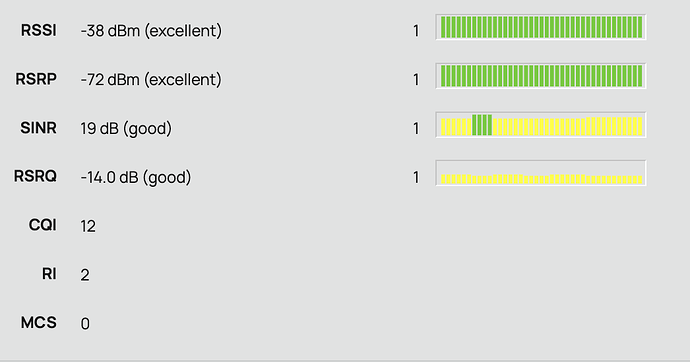

Typical LTE values after optimization:
RSRP: around -70 dBm
SINR: around 19–25 dB
RSRQ: around -9 to -13 dB
CQI: often good
Carrier Aggregation: B3 primary, sometimes B3+B8
So from a pure radio perspective, the connection looked fine. During the day (see screenshot), the signal is weaker than in the evening. The weather can also affect the signal.
Still, the real-world experience was inconsistent. Google Meet sometimes had audio/video glitches. Gaming latency was unstable. YouTube could buffer or stutter. Ping tests showed occasional spikes even though the average latency looked acceptable.
The important lesson: good LTE signal values do not automatically mean good real-time performance.

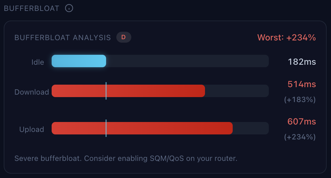

Without shaping, my bufferbloat tests looked terrible:
Idle latency: around 140–180 ms
Download loaded: 400–600+ ms
Upload loaded: 250–600+ ms
Bufferbloat: C / D
That explains why the connection felt bad even when “speed” seemed acceptable.

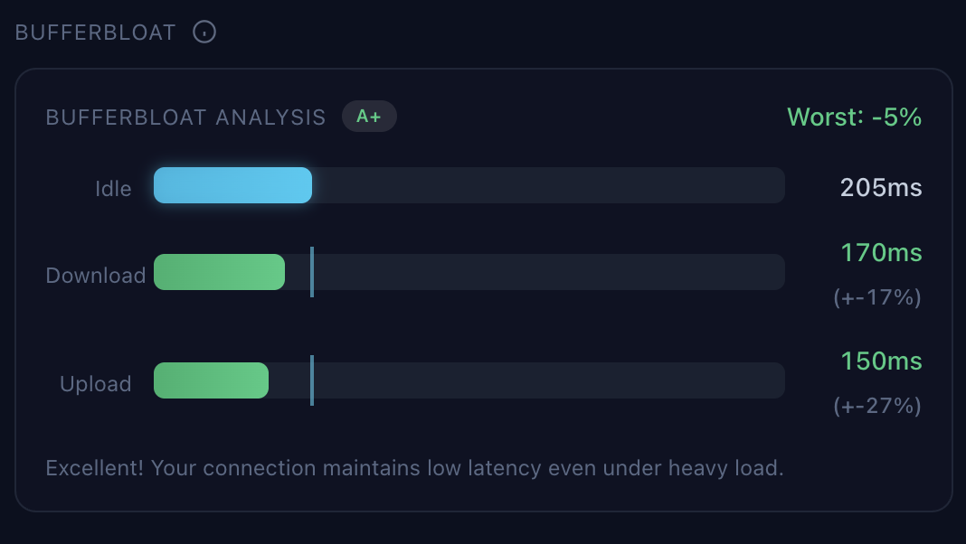

With the 25M/40M shaper active, bufferbloat tests improved significantly:
Idle latency: around 199–205 ms
Download loaded: around 170–218 ms
Upload loaded: around 150–174 ms
Bufferbloat: A / A+
The absolute idle latency is still LTE-like and not comparable to fiber, but the important part is that the latency no longer explodes under load.

  3. Bufferbloat can destroy usability even when speed looks good.
  4. Upload shaping is easier than download shaping on LTE.
  5. Download limits must be below the reliably available LTE capacity.
  6. For my connection, 40 Mbps down is much better than unstable 80–100 Mbps.
  7. FastTrack must be disabled for queues to work.
  8. Wi-Fi jitter can look like LTE problems.
  9. WPA2 only was more stable than WPA2/WPA3 mixed in my setup.
  10. Ping watchdog is risky on LTE if configured too aggressively.
Conclusion
The best result was not achieved by chasing maximum throughput. It came from accepting a lower but stable bandwidth limit.
In my case:
Theoretical LTE speed: up to around 100 Mbps
Practical stable limit: 25M upload / 40M download
Result: much better latency and real-world usability
This setup is not meant to win speed tests.
It is meant for people who need a stable connection for real-time applications:
  • home office
  • video meetings
  • Slack / Teams / Zoom / Google Meet
  • online gaming
  • VoIP
  • remote desktop
  • general work where short dropouts are more annoying than lower download speed
For these use cases, a stable 40 Mbps down LTE connection with controlled latency is often much better than an unstable 100 Mbps down LTE connection with 600 ms latency spikes.
Since I am in Germany on the Congstar/Telekom LTE network, users in other countries or on other carriers may find a different sweet spot. The exact bandwidth limits are less important than the method:
  • measure
  • separate Wi-Fi from LTE
  • disable FastTrack for queue testing
  • shape below the reliably available capacity
  • optimize for latency, not peak throughput
For LTE users, especially those working from home, gaming, or using video calls, I strongly recommend testing bufferbloat and not only raw speed.
