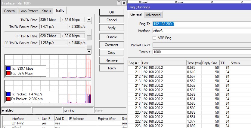

Can you try LTE passthrough on VLAN instead of ether1?
Sure thing. It works as expected.

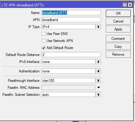

On the LHG R, I created vlan100 bound to ether1, set the LTE passthrough to the VLAN interface…
..and a matching vlan100 bound to ether3 on my CRS109 set up with DHCP. It grabs an address as expected and appears to work just fine.
I set a temporary IP bound to ether1 on the LHG and ether3 on the CRS. I was able to ping untagged between my LHR and CRS while LTE passthrough was working on vlan100.
I had originally considered this since I wanted to keep management access untagged for ease of access when directly attached to a PC. I decided to set the LTE passthrough untagged in an attempt to keep internet traffic as untouched by the CPU as possible. I’ve seen occasions where the LHG’s CPU usage gets a little high. I would be tempted to increase clock speed if the box wasn’t in direct sunlight. Maybe I’ll try it in winter. :laughing:

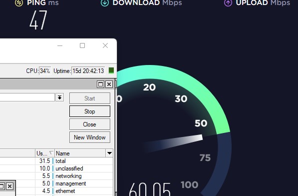

Just did a quick test of CPU usage. With the LTE passthrough still set to a VLAN interface, CPU usage appears to be ~30-40% at 60Mbps download speeds and 20-30% at 15-20Mbps upload.

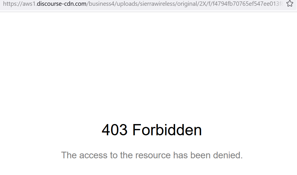

I was unable to open links with examples that said @here and here@ Page said “access denied”
Update: Looks like i found what pins need to be taped. Will try later today and see how this will workout.
The RBwAPR-2ND (wAP R) requires taping the pins as does not have the USB 3.0 pins wired. Alternatively, never tried this either, but in some newer firmware version Sierra added an AT command to set the USB speed, AT!USBSPEED=0 to force USB 2.0 mode them.

You should be able to get the firmware from https://source.sierrawireless.com if you register for an account.
