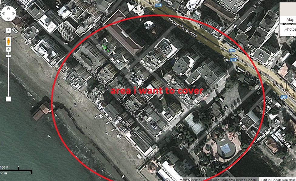

i want to create a mesh network in my neighborhood so all Ap act as one.
topology
internet > radius server " RB750" > swich > Ap 1,Ap 2 , ad soo on.
but i want to connect all AP using wired cable for better performance.
have attached some pics topology how i think to do it.
i need ideas on how to get this right
i want to use RB METAL 2SHPn
First of all, metal has only one eth connector, how you can connect 3 wires as described to ap4? I would suggest to connect all aps independently and not to play with mesh as it does not seem to be necessary.

i will use something like this
"connect all aps independently "
yes that’s what i want to do , but still i think i need mesh so all Ap’s can act as one , so users don’t need to disconnect from ap1 and than connect to Ap 2 if they are in move
most of users will use smart phones .
No. Even caps manager wil not provide such functionality. You live in far future.

so you saying it’s still not possible to make all Ap acting as one Ap. :confused:
Exactly. It was written enough on this forum. There is no “unifi”-like functionality on mikrotik. Use search and read some articles here…
