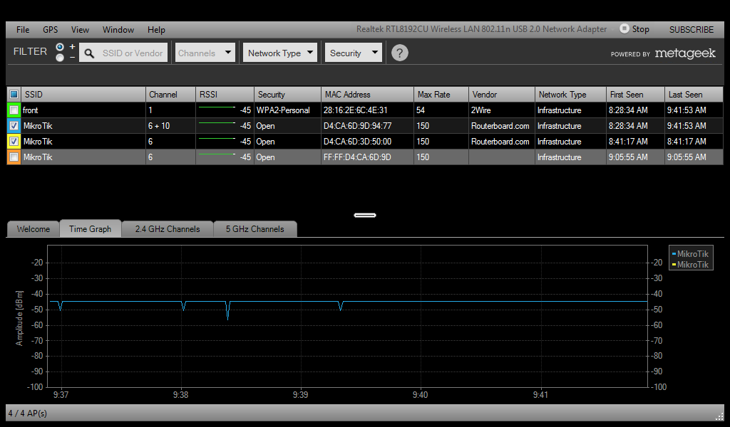

Model Metal 2SHPn
Serial Number 4475024B3344
Current Firmware 3.09
Mac address changes on wifi
mac is D4:CA:6D:9D:94:77
on channel 6+10
insidder program also slows
D4:CA:6D:3D:50:00
FF:FF:D4:CA:6D:95
ON channel 6

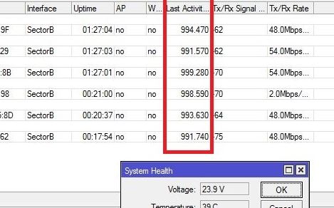

I’ve got the wireless client count checking script mentioned in one of the metal2.4 threads running so we at least do not have long periods with no traffic, the reboots are quick. Theres 2 of those type reboots in the log below.
But as you can see there are two other reboot types that occur… kernel issues, and i guess just watchdog reboots are the “without proper shutdown” ones.
