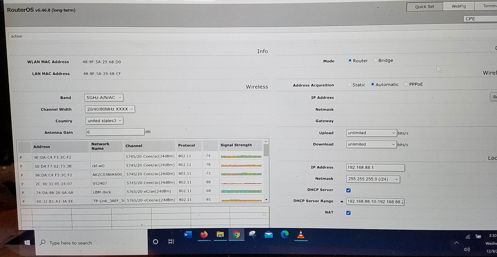

Here is a screen shot of the configuration

You’ve got a bunch of access points showing in the scan window and a bunch more if you pull the slider down. If the unseen AP’s are 2.4GHz signals they wouldn’t be seen because you are only scanning 5GHz signals. Try changing the Channel Width to 20/40Hz XX and Band to 2GHz-B/G/N. This will change the scan to 2.4ghz stations
That’s the problem–it won’t let me change to 2.4 GHz. Insists on staying on 5! I try to switch and it just springs back to the setting you see in the screen shot I sent.

CPE quickset can only handle devices with one WLAN interface. The script gets confused when there are more WLAN interfaces. (e.g. setting parameters on one interface and using another interface while scanning). Webfig or WinBox are not difficult at all to correctly set up or adjust a CPE configuration.
CPE script seems to have been made for ROS level3 devices that never can act as AP, and not even have a second WLAN interface.
If this is not a problem for the Metal 52c, then also remember that “united states3” will only see some frequencies, depending on the installation setting. (outdoor ???)

After reading what you guys said, here’s the problem and solution.
The CPE could not find the mesh because it was scanning only the 5GHz A/N/AC band. When I tried to change ti in the Quikset menu, it would not accept the change.
I as using the web interface, so one suggestion was to use Winbox directly from a computer and not through through the router.
That didn’t work.
A friend suggested using WebFig, selecting the wireless connection, and torching it. Well, that option apparently is not available through Winbox.So I went back to the wireless connection through the router and tried it.
That didn’t work.
I’m at a bit of a disadvantage here, as I don’t have one of these units available here in the office to play with. I can’t remember the exact menu, but I again went into the wireless connection and changed the band 2.4. It said it couldn’t do that because it was incompatible with the channel width which I had been told to set as 20/40/80MHz XXXX.
I had the channel width on the access points set to 20MHz, so i changed it to that value in the wireless configuration and told it to save the change.
I next went back to Quick Set and there all the APs were! I selected the mesh and entered the password and we were in!
