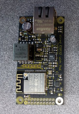

Plattform ESP32 seems something like that →

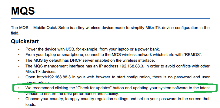

We recommend clicking the “Check for updates” button and updating your system software to the latest
version to ensure the best performance and stability

MQS quickstart-guide says actual sw-version is 1.2p.
With default-configuration MQS has a DHCPd enabled on it’s wireless interface … try these steps.
