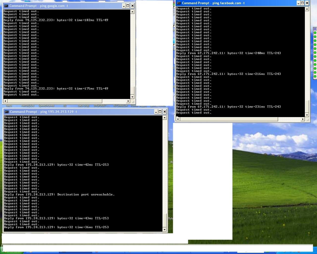

this is because some time, my ping Start showing time out.then if any download is on,it will keep downloaded. but you can’t open pages anymore.
Then wen i reboot the Mikrotik or the ADSL modem, it will came normal for some Short time then start back after.
What can be the problem?

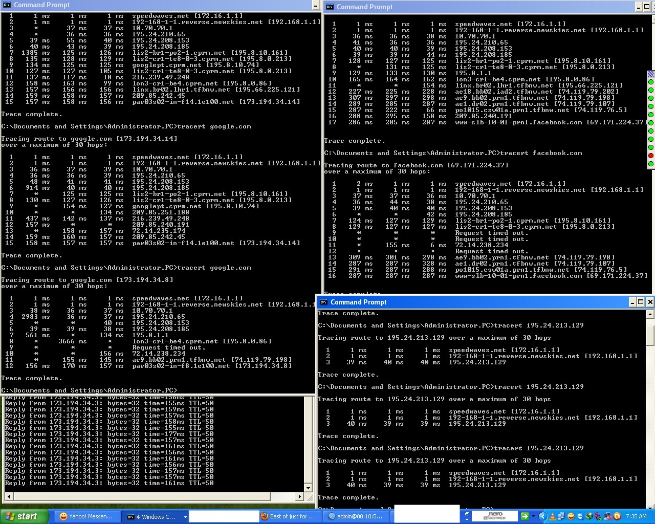

here are the first results
This is when the Connection is the best
Alright, thanks for including both tracert results for when the connection is ok and when its not. i’m going to guess 192.168.1.1, is your routeros ip address and anything after that point, is your isp. including 10.70.70.1 and 195.24.213.129. if my assumptions are wrong, please correct me.
As you can see, something really fishy is going on. when your traffic is routed through 10.70.70.1 , your connection is fine but when it goes through 195.24.213.129 , your problem starts to appear(please make sure that its really the case. try it couple of more times when your connection is fine and when its not to see if it stays like this). first question that comes in mind is that why does it take two different routes. i’m not quite familiar with routing protocols but are you using any?
you said you’re using adsl. my guess is you have bridged that to your router and you router is connecting through pppoe or something, is that right? do you experience a lot disconnections?

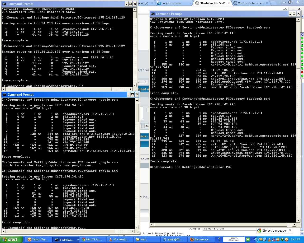

for the next step, do the following:
tracert 10.70.70.1 , when you experience those ping timeouts again. do it couple of times and post the result.
post ‘/ip route print detail’ for both when your connection is ok and when its not.
Unless you are using multiple links in your router or using some sort of routing protocol that i have no idea how they work, i think at this point, its safe to say, the problem is your isp. but there is a slight chance that you could fix it by adding a static route.

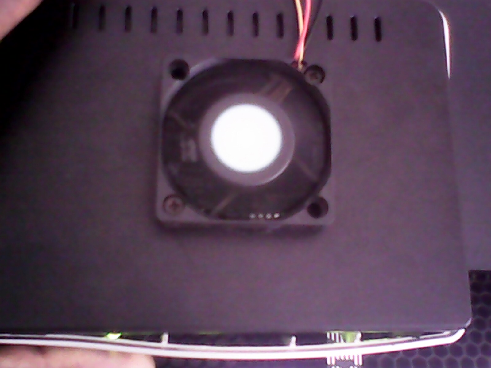

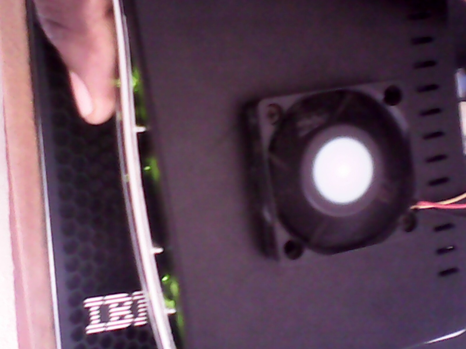

I buy a new adsl modem which I have attached a fan. [D-link DSL-254OU]
up to now, it seem to be working fine.

The problem just start again with the new modem.
wen the Default Gateway is : 195.24.213.129
but,
wen the Default Gateway is : 10.70.70.1, the connection is gud.
I will get back to you after contacting my ISP.
