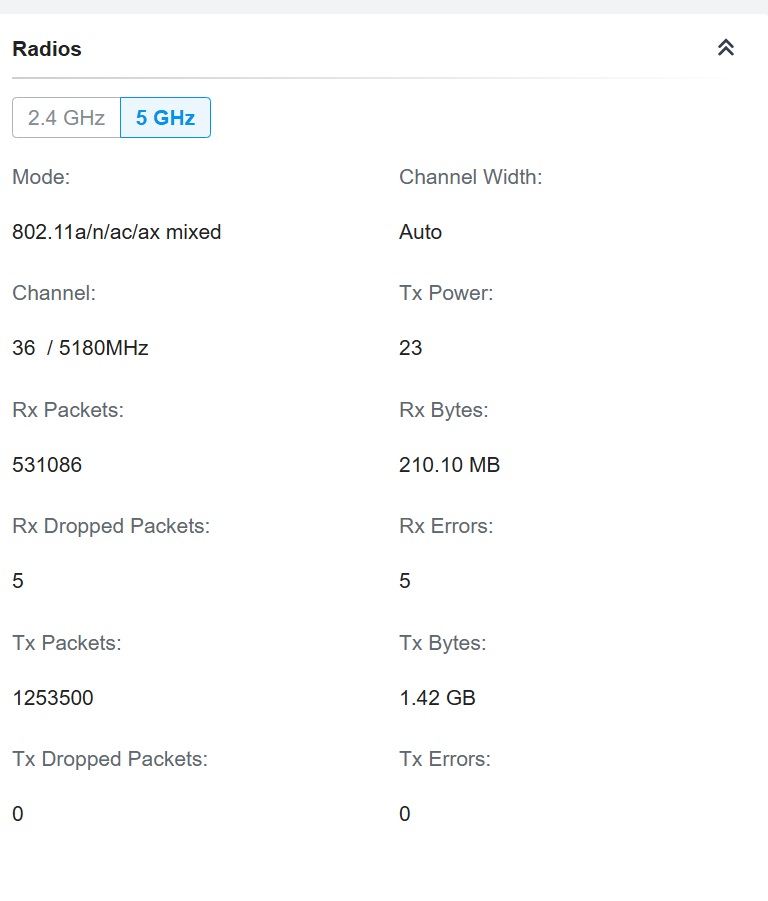

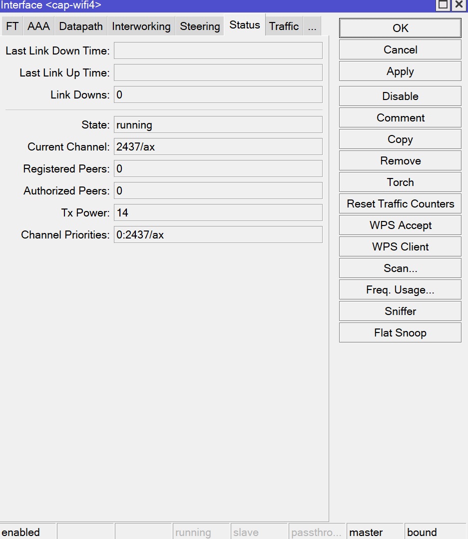

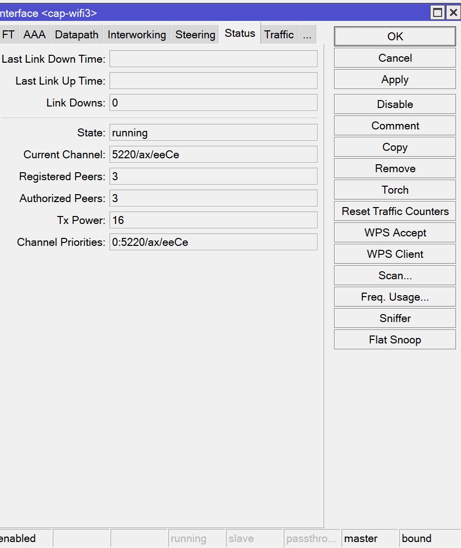

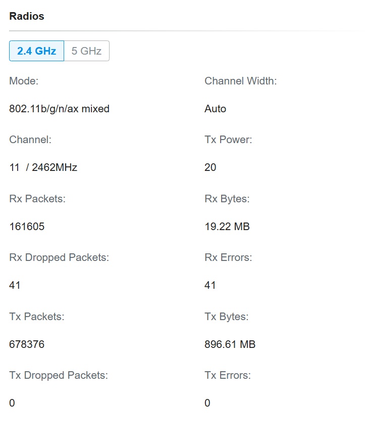

Here are some photos, TX power from TP-Link and Mikrotik, power on both set to auto, country set to Croatia:
TP-Link 2.4 GHz:
Mikrotik 2.4 GHz:
TP-Link 5 GHz:
Mikrotik 5 GHz:

I assume you comparing CAP AX. Mikrotik shows TX Power excl. antenna gain. For comparison:
  • 2ghz: 20 tplink vs 14+6 (antenna gain) Mikrotik
  • 5ghz: 23 TP-Link vs 16+5.5 (antenna gain) Mikrotik
I guess they can up the rx gain and not have to worry about any triggers with DFS etc.
