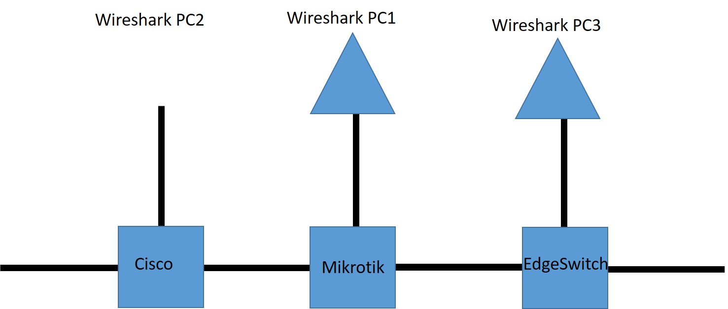

I was doing a packet capture with Mikrotik router but in bridged mode. Ports 1,2,3 and 4 are in a bridge and port 5 not. Streaming from port 5 that has an IP address of 192.168.7.4 to Wireshark PC1 192.168.7.5 there are a lot IP packet errors from the packet capture with the Mikrotik. So I setup 2 more laptop with Wireshark and started a packet capture from a Cisco switch and an Edge switch at the sometime with Mikrotik. The Cisco and edge switch show the same IP packet with very little packet errors but the Mikrotik packet capture show lots of IP packet errors. And don’t match the packet capture form the Cisco or the Edge switch.
So my question is why does Mikrotik packet capture have lots of errors and don’t match other 2 packet captures?
And is Mikrotik Packet Sniffer Broken?
