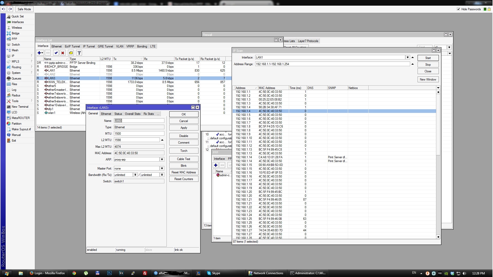

I have 1 PC with IP 192.168.88.200 and It needs to watch DVR all the time (dvr ip 192.168.3.201)

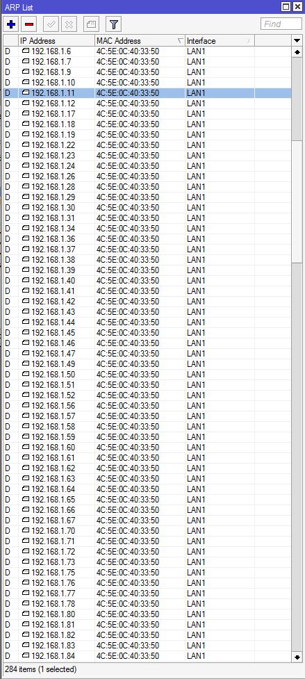

So, when I have ARP:Enabled on ether4, PC 192.168.88.200 cant see DVR. When I set ARP:arp-proxy, PC can access DVR and everthings fine, BUT, all IP’s on ether2 get some wierd clones (with same MAC address) on every address, I will post screenshots from IP scan so you can get what im talking about :confused: When I set arp-proxy on ether4 my LAN with pcs (192.168.1.0/24) gets some annoying double IP’s (with all same MAC address) and cant function properly.

I understand when is ARP-proxy supposed to use, but I just cant ping anything except router on interface (in this example 192.168.3.1) without proxy-arp.
bump, anyone ? :confused: This is ARP list I get, as you can see all ips from 1.1-1.254 with same mac when proxy-arp is enabled, and when arp is only enabled ether4 cant comunicate with wlan,or any other interface.
