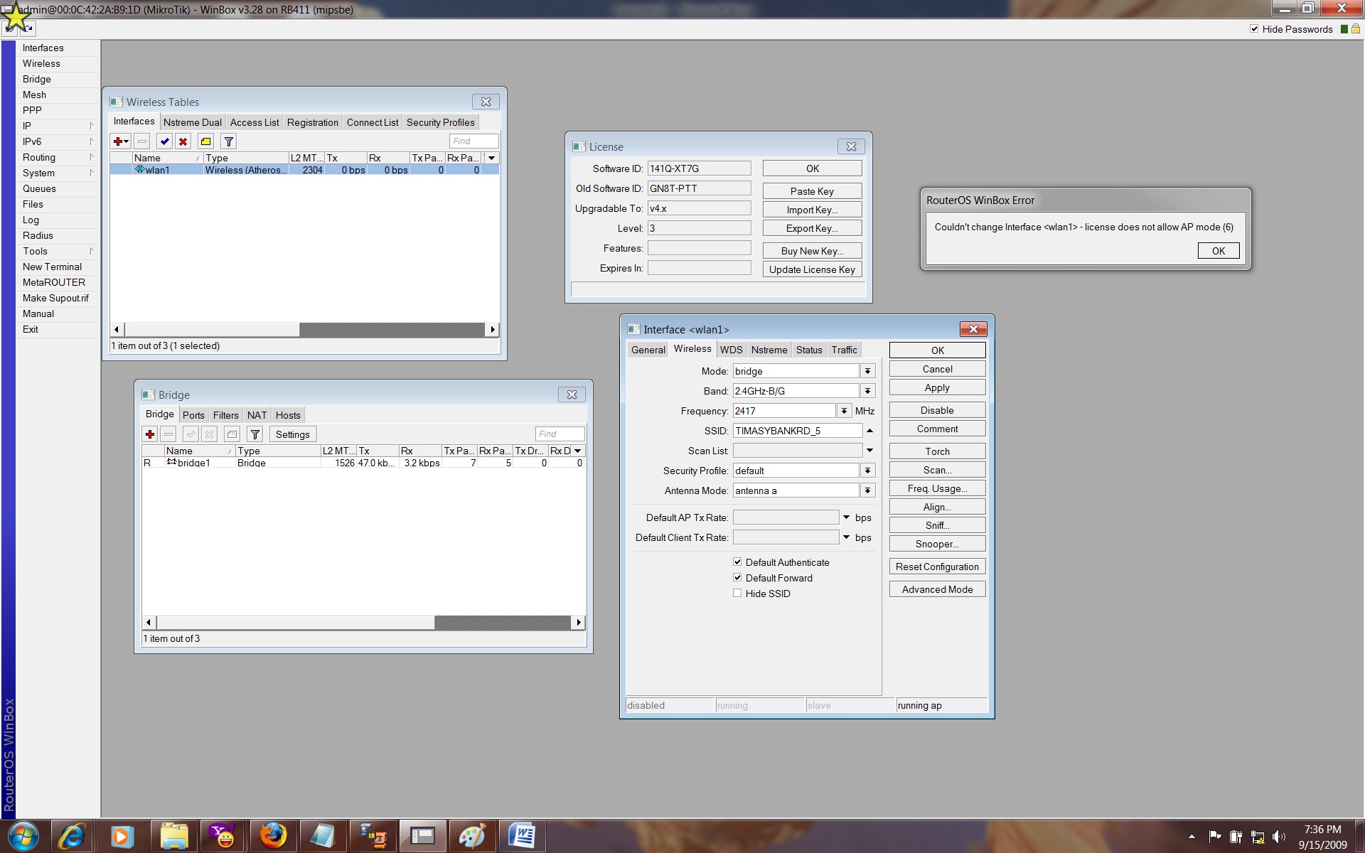

Just take a look at this picture and advice me. i have this radio, whihc i want to use as an access point, but when i change it to Ap+Bridge, it shows license do es not support ap+bridge mode. i have upgraded the router boarrd hoping it will solve the problem yet it did not solve it. Will leaving it in bridge mode as the picture make it as access point so that clients can connect to it.

A level 3 license, like you have in that RB411 can work as a wireless client, but not AP. Even if you upgrade routeros on it to v4.x you still have a level 3 license.
http://wiki.mikrotik.com/wiki/License_levels
Leaving the radio in bridge mode will allow only 1 client associate with it.
http://www.mikrotik.com/testdocs/ros/3.0/interface/wireless.php
I would stick with the RB532 you mentioned earlier.
