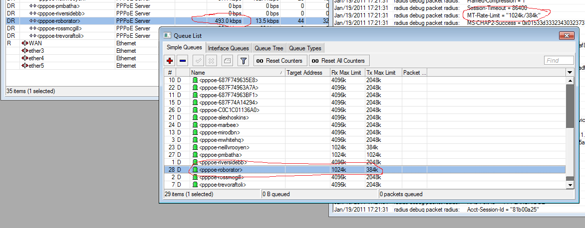

I have an RB450G set up as a PPPoE Server for my Clients that is set up with radius for my server.
The Clients can authenticate on the PPPoE Server and the Radius Server does pass Mikrotik-Rate-Limit to the PPPoE Server.
It also dynamically creates simple Queues for the pppoe clients with the correct RX and TX rates eg: 1024k upload and 384k download
The problem is that the queues don’t work. The clients can still download faster then 384kbps for eg.
I am using RouterOS version 4.16 with radius topic set on the log
When i check the log on the routerboard for radius events it shows an Accounting Accept Packet with MT-Rate-Limit =“1024k/384k”

I have figured out that I had a PCQ set up under the Queue trees and that stopped the simple queues from working.
I disabled the Queue tree and The Rate Limits on the simple queues started to work.

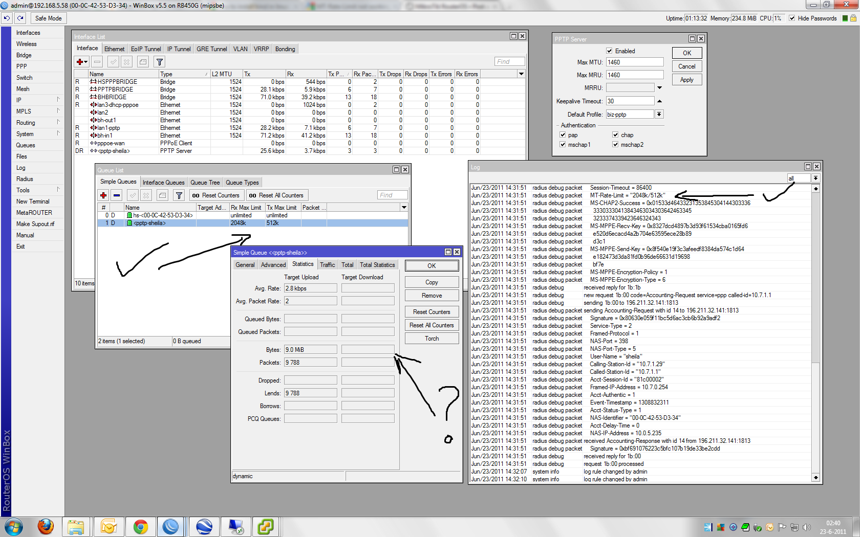

I have Encountered this problem again now in Version 5.4 of Router OS on a RB450G. I Have a PPTP Server that uses my radius server authenticate users. The radius passes back MT-Rate-Limit=“2048k/512k” and the Dynamic Queue is created under simple queues but the Download Rate does not work.
NB. this time I also do not have any PCQ or Queue Tree setup.
Most probably the PPP server is on a bridge.
/interface bridge settings> set use-ip-firewall=no
Thank You. That does seem to solve the problem. If I untick the option for “Use IP Firewall” under Bridge settings it does work. The problem now is that my PPTP Server Profile has an option for BRIDGE and if i deselect it PPTP clients cannot login.
