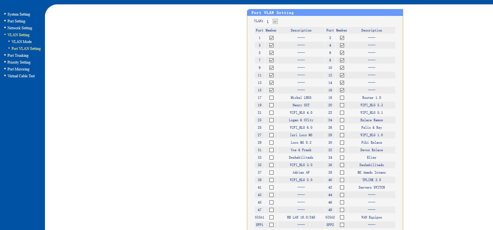

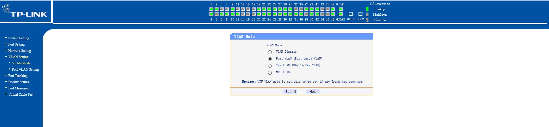

I have it configured as follows, all the devices are around 20, they are on a slplink model sl2452web switch, there on the same switch I split the ports using vlan ports (separate each port forming a kind of independent switch between them) for each port only see the port giga 1 and do not see each other so avoid the broadcast, and port giga1 goes to the port eth1 of the routerboard, and from there the traffic to the port eth2 of the same routerboard where it goes to the servers, this is the configuration that I have, and in another port of the routerboard comes the cable from another part of the switch where there are 8 ports that are in another ports or divided ports so that they do not see each other, this is how I have formed the network some advice?

None which would lead to decreasing the load on the Mikrotik, as none of it comes from bridging, it all comes from routing.
