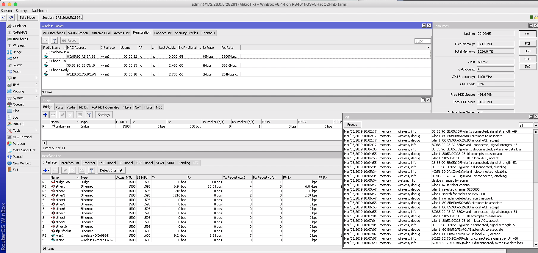

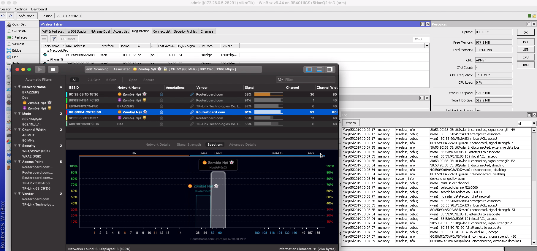

Make a different frequency on the RB4011, different from other devices. See how the interface crashes on RB4011. And IPv6, dual-stack on iPhone XS Max
if you need video of the interface crash, I can send it to the mail. Do not publicly spread.
RB4011 frequency 5260, RB962 frequency 5180. iPhone XS Max switched to RB962, then switches to RB4011 and 5ghz falls. My computer also shuts down from RB4011. If you use the range in the network 5180-5240 - the departure does not occur. Something with a central channel on RB4011. RB962 insures the central channel is obtained if you use 5180-5240 frequency. If RB4011 use different central channel of RB962 then 5ghz on RB4011 crash.

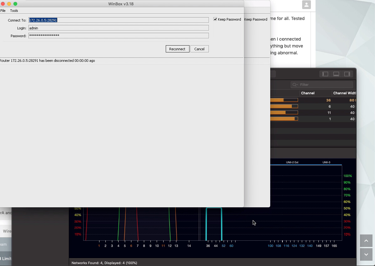

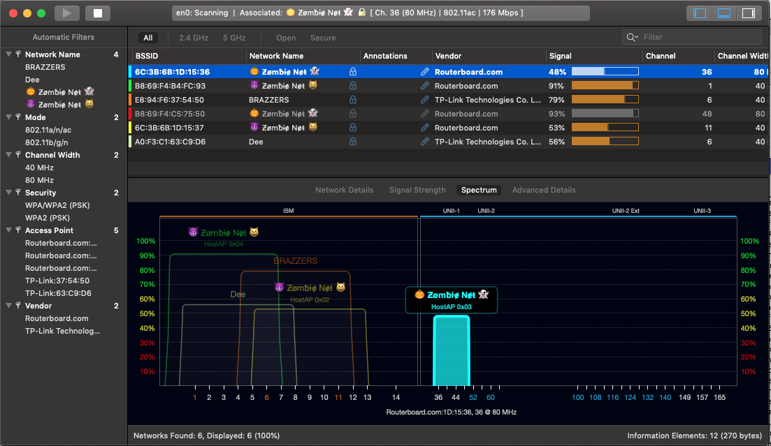

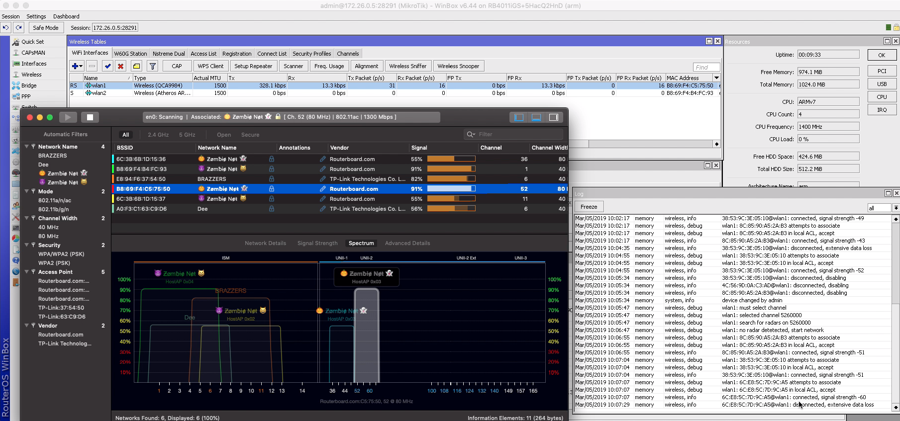

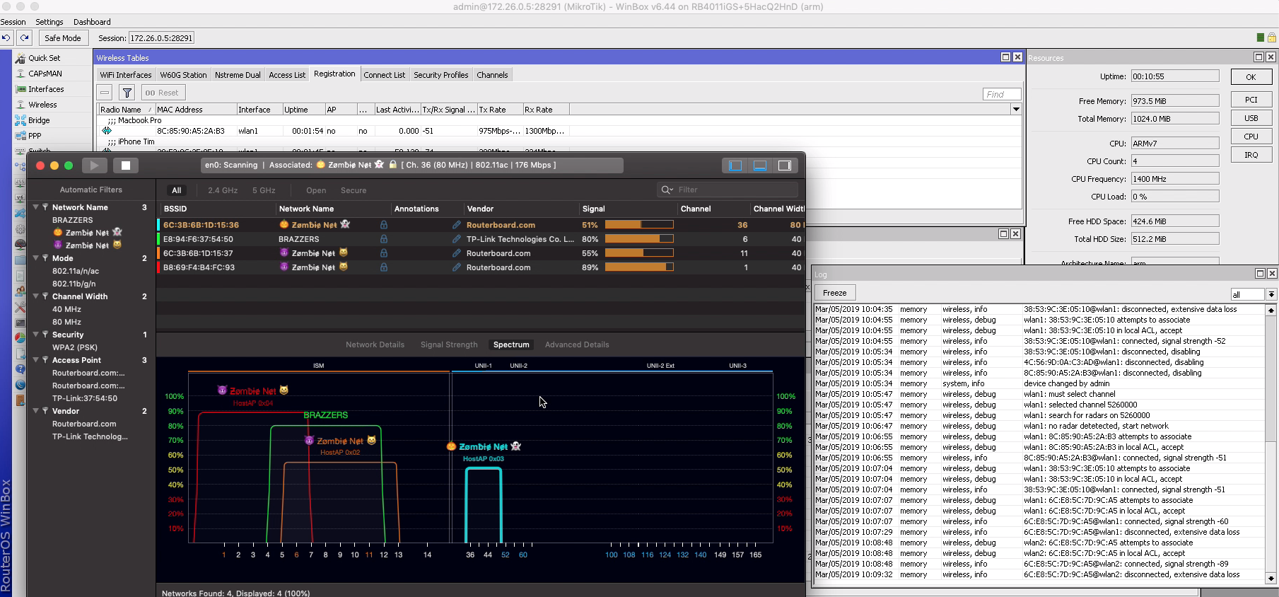

Now in capsman RB4011 stood at 5240, RB962 stood at 5180. After 10 minutes of operation, RB4011 fell. IPv4 / IPv6.
So it’s not a problem in the central channel.
RB4011 only works steadily if RB962 and RB4011 are on the same channel.
the screen shows that 5ghz from RB4011 is not, crash.
