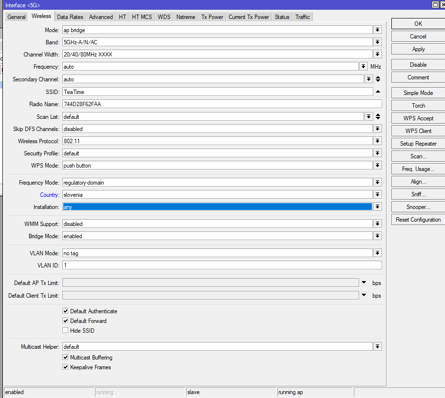

Sorry one last thing. I was looking at Antenna gain settings and I can not find them for the life of me. Can you point me in the right direction?-
Directly connected means without the RB in between. Or did you mean without the RB you get Gigabit?
Wireless interface, make sure Advanced mode is enabled.
I tried both versions, with RB and directly between two Windows 10 machines. The logs above are from a Windows 10 to RB 4-B connection.
I am still unable to find Antenna Gain option:
There we go: http://forum.mikrotik.com/t/lhg-5ac-cant-set-regulatory-domain/140243/1
Can you please share /interface wireless export hide-sensitive?
I’m still missing file transfer speed test while both Windows clients are connected directly.
[Update]
Something changed:
/interface wireless
set [ find default-name=wlan2 ] band=2ghz-b/g/n channel-width=20/40mhz-XX country=slovenia distance=indoors frequency=auto mode=ap-bridge name=2G ssid=TeaTime station-roaming=enabled \
    wireless-protocol=802.11 wps-mode=disabled
set [ find default-name=wlan1 ] band=5ghz-a/n/ac channel-width=20/40/80mhz-XXXX country=slovenia disabled=no distance=indoors frequency=auto mode=ap-bridge name=5G secondary-channel=auto ssid=\
    TeaTime station-roaming=enabled wireless-protocol=802.11 wps-mode=disabled
/interface wireless manual-tx-power-table
set "5G" manual-tx-powers="1Mbps:0,2Mbps:0,5.5Mbps:17,11Mbps:17,6Mbps:17,9Mbps:17,12Mbps:17,18Mbps:17,24Mbps:17,36Mbps:17,48Mbps:17,54Mbps:17,HT20-0:17,HT20-1:17,HT20-2:17,HT20-3:17,HT20-4:17,HT20-\
    5:17,HT20-6:17,HT20-7:17,HT40-0:17,HT40-1:17,HT40-2:17,HT40-3:17,HT40-4:17,HT40-5:17,HT40-6:17,HT40-7:17"
set [ find default=yes ] authentication-types=wpa2-psk eap-methods="" mode=dynamic-keys supplicant-identity=MikroTik

[  4]   3.00-4.00   sec  33.2 MBytes   280 Mbits/sec
[  4]   4.00-5.00   sec  29.1 MBytes   243 Mbits/sec
[  4]   5.00-6.00   sec  27.5 MBytes   231 Mbits/sec
[  4]   6.00-7.00   sec  28.5 MBytes   240 Mbits/sec
[  4]   7.00-8.00   sec  29.9 MBytes   250 Mbits/sec
[  4]   8.00-9.00   sec  26.9 MBytes   226 Mbits/sec
[  4]   9.00-10.00  sec  28.0 MBytes   235 Mbits/sec
[ ID] Interval           Transfer     Bandwidth
[  4]   0.00-10.00  sec   308 MBytes   258 Mbits/sec                  sender
[  4]   0.00-10.00  sec   308 MBytes   258 Mbits/sec                  receiver
iperf Done.
The 802.11ac should have a realistic scenario of 210 Mbps - 1000 Mbps, but even being near router, all I can get is around 320 Mbps. My connection in Windows is defined as 866.7 Mbps.
40-50MBytes/sec = 400Mbit, seems not to bad for network drives even on PC.
How much do you get with different router or direct PC to PC connection?
It was the PI in the end, it doesn’t seem to handle more than 45MB/s transfer rates, probably the SD card.
