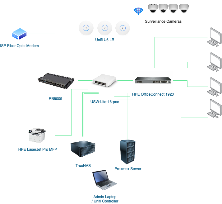

Hi there, I have a similar setup and I am new to both Mirkotik and Ubiquiti devices. :slight_smile:
The goals are to
  1. Setup a guest network with Wifi internet access only. That is, no access to other devices/ networks
  2. Setup Wifi and wired network for those computers connected to HPE OfficeConnect 1920 switch with access to Internet, the LaserJet Pro, Samba sharing at TrueNAS and some selected VMs/ Containers at the Proxmox Server only
  3. Setup a Wifi network for the surveillance cameras. NVR application runs at the TrueNAS server. This network should not have internet access.
  4. Setup an Admin network to maintain these devices: RB5009, USW-Lite-16-poe, Unifi U6 LR AP, HP OfficeConnect 1920 switch, TrueNAS, Proxmox Server, Surveillance cameras & HP LaserJet Pro
I’ve been playing with the Unifi new and old UIs back and forth. So far so good and here are some ref links
For Mikrotik, I am reading about mikrotik vlan setup and the configuration files here.
Watching YouTube videos
Do Bridge VLAN filtering or VLAN at mikrotik build-in switch chip? Still very confusing. As shown in the diagram below, I use RB5009’s port 1 to connect to ISP modem and port 2 as the trunk port for collecting the USW-Lite-16-poe switch. This should be what they call router on a stick.
