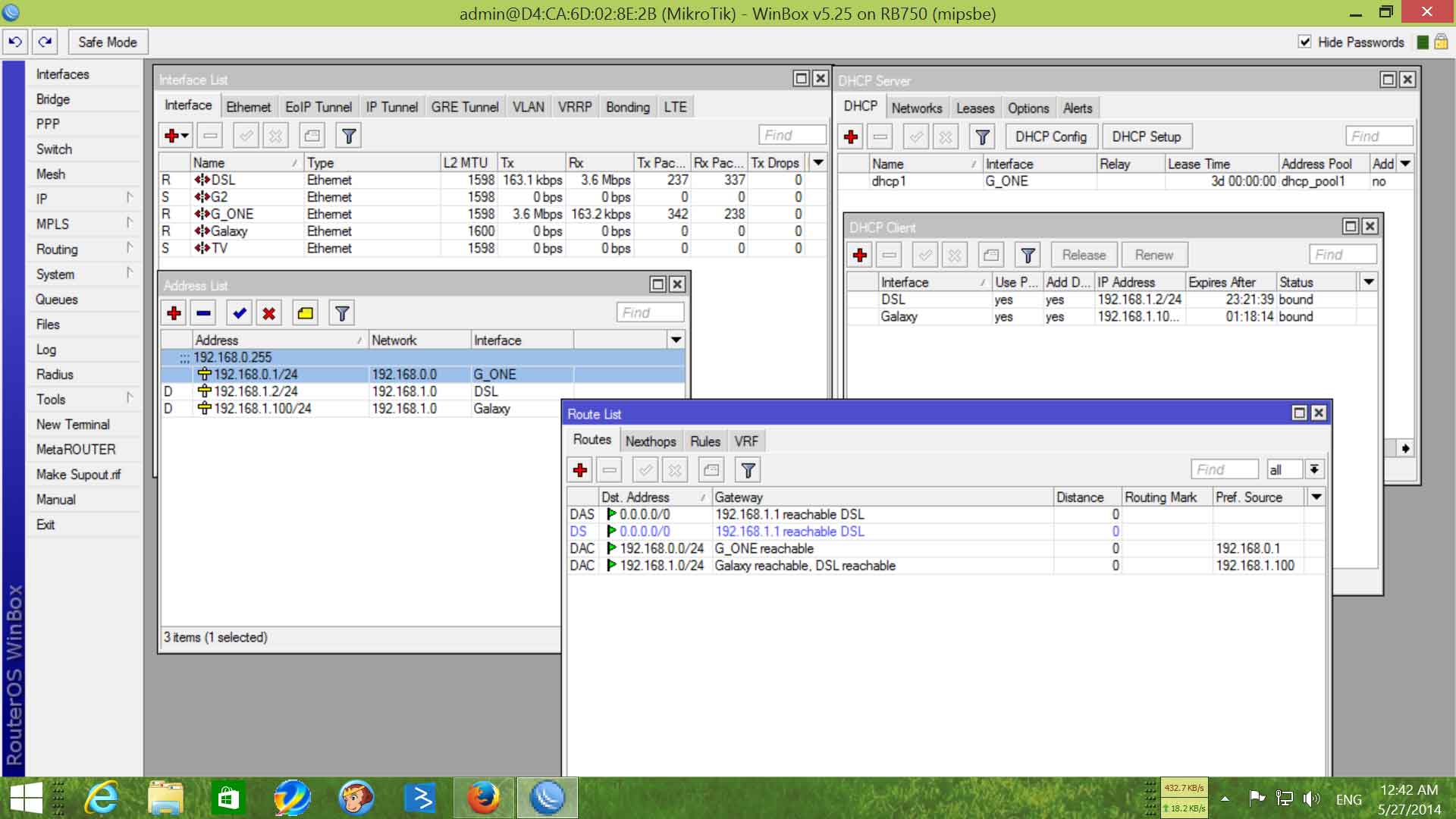

I have Been trying almost a weak now to configure Newly purchased RB750. to Load Balance my 2wan connections
Tried many Mangle rule and Scripts found on wiki but no luck.
Here are my ips assign by my isp1 and isp2
Wan1 = 192.168.1.100 (Dynamic)----------------Name Galaxy
Wan2 = 192.168.1.2 (Dynamic)------------------Name DSL
Local = 192.168.0.1 (Assign by Me)--------------G_ONE
I’ll be grateful if someone show me mangle rule with the above config.
Both Wan Working fine individually if both connected wan2 (DSL) woks as Priority wan1 stops
many thanks for reading waiting for guru help
Doesnt look like you have set your other static route to be in the routing mark you are mangling. Wont work until then because currently both static defaults have the same AD.
Just realized from your image that you dont have a second default static configured, in any case, it would need to be in its own routing mark so that packets that get mangled through the firewall follow that route.
