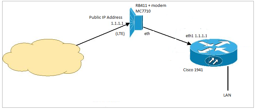

I´m new in the forum, and after seeing this topic i was very interested, beacause i´m triyng to do something like that.
I have the following scenario:
One RB411 (old one :slight_smile:) with a modem sierra wireless MC7710 (LTE), where i get the public ip address, but I want to pass the public ip transparently to the cisco 1941 through Eth. Then the idea is the cisco router do everything i want.
My thought was to do some bridging on interface LTE and ETH, but it seems is not possible, now i’m stuck. How can i do this in a easy way??
Thanks for response.
I think your best bet is to configure the Cisco with a static private IP, and then on the Mikrotik, dstnat everything to the Cisco’s private IP.
