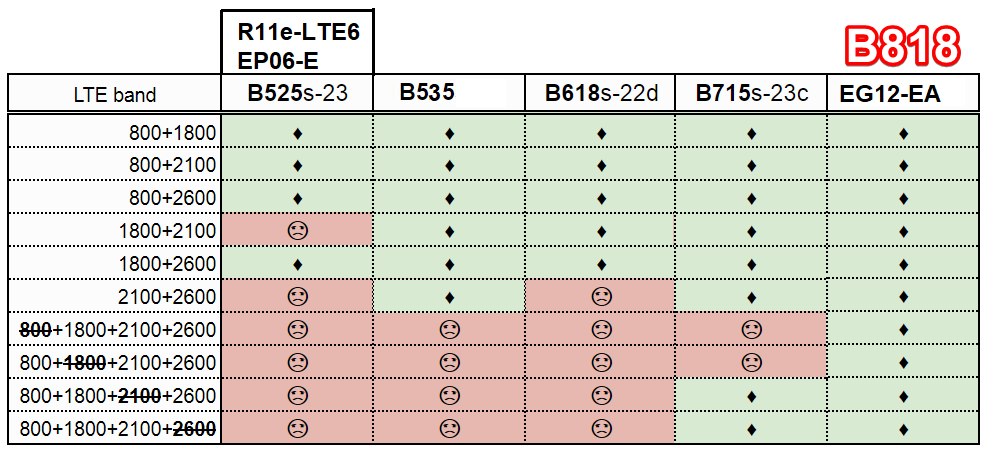

Few stuff
B818 Cat.19 vs R11e-LTE6 Cat.6
B818 without external antenna vs LHGR+R11e-LTE6 who have own antenna
Check R11e-LTE6=B525 vs EG12~B818
B818 probably connect and assign/aggregate/sum few Bands together, your details give info about only one band, are not complete.
