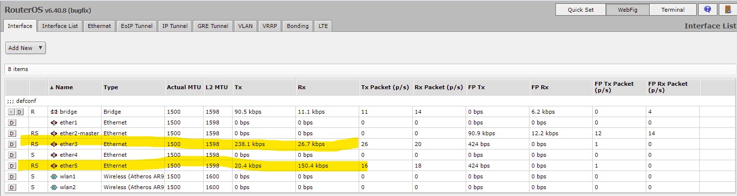

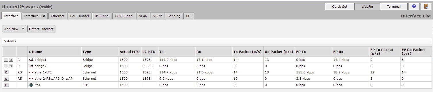

I have a SXT LTEkit - 4G linked back to a hAP ac Lite: Router and forward to a MikroTik RBwAP2nD (wAP) Outdoor. The hAP has internet access via ADSL MODEM which is not getting through to the Outdoor wAP..
I can’t raise the Outdoor wAP via web browser or winBox.
The LTE-MODEM interface list shows the Outdoor wAP but with no traffic flowing.
The hAP Router interface list shows traffic on ethr3>5 which I think is the ADSL being available to LTE MODEM on “5-PoE OUT”.

It would help IMMENSELY if you, instead of posting some non-relevant screenshots, provided us the export of your config.
Ideally of all related devices.

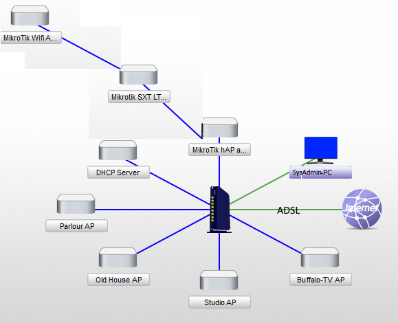

A small diagram (can be a sketch on paper) will also help to understand how things are connected.

BTW that first screenshot is from which device ? ANCIENT version of ROS … why not use latest stable (6.49.6) or long term release (6.48.4) ?
Second screenshot: less ancient but also overdue for upgrade, I think.

  2. Provide a network diagram what devices are connected to the port, and what subnets are flowing through the ports on the router and where is the internet coming from.

No RouterOS documentation was left by installer, so switching back to ADSL MODEM has been hit & miss - mostly the latter, but I’ve now worked out how to dump the hAP & MODEM config files & drawn a network diagram.
Hope the attached gives clues as to why the Mikrotik side won’t talk politely to the local network
