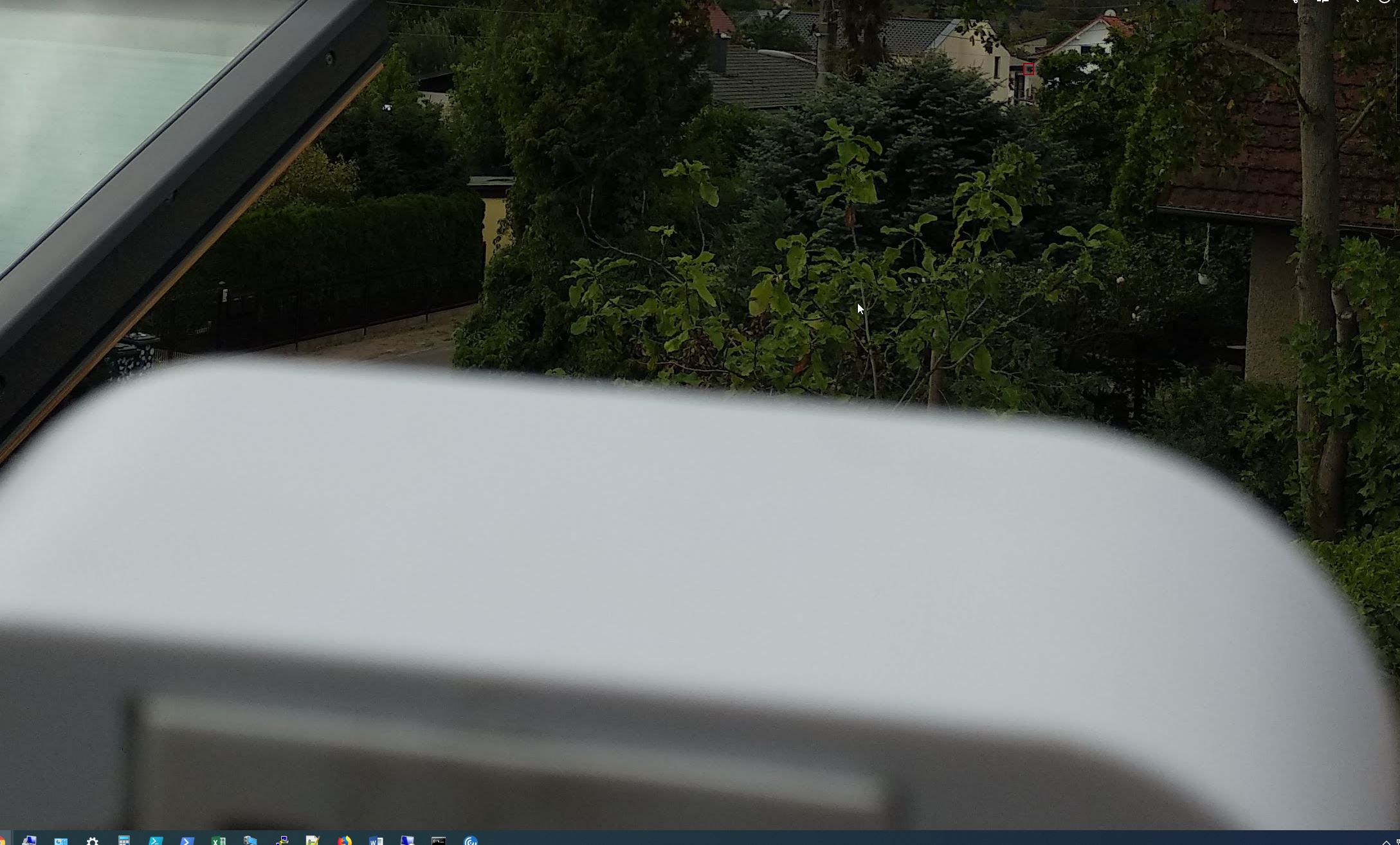

Attached a picture of the situation, i marked the other ap.

From picture it seems, that nearby trees may be covering line of sight during winds, please try with higher frequencies as well.
