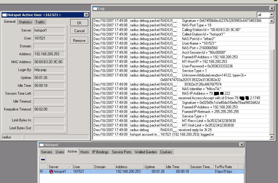

Log RADIUS:
Packet R1 16/12/2007 20:50:53.109
IP address: 79.xxx.xxx.222
Source Port: 1024
Code: 1 [Access-Request]
Identifier: 0
Length: 180
Authenticator: 67 45 8B 6B C6 23 7B 32 69 98 3C 64 73 48 33 66
Attributes:
61: 19 [NAS-Port-Type (Unknown)]
31: 00:60:B3:2D:9C:80 [Calling-Station-Id]
30: hotspot1 [Called-Station-Id]
87: ether2 [Unknown]
1: 161521 [User-Name]
5: 2151677952 [NAS-Port]
44: 80400000 [Acct-Session-Id]
8: 192.168.200.249 [Framed-IP-Address]
26: 14988 [Vendor-Specific]
10: АЁИщ
2: 963326 [User-Password]
6: 1 [Service-Type (Login)]
26: 14122 [Vendor-Specific]
3: http://192.168.200.1/logout
32: MikroTik [NAS-Identifier]
4: 79.xxx.xxx.222 [NAS-IP-Address]
Source:
Packet W1 16/12/2007 20:50:53.328
Destination Port: 1024
Code: 2 [Access-Accept]
Identifier: 0
Length: 68
Authenticator: 32 21 9A E1 D4 A7 CC 73 9D DE 91 41 77 C7 77 EB
Attributes:
9: 255.255.255.255 [Framed-IP-Netmask]
1: 5242880
2: 5242880
Source:

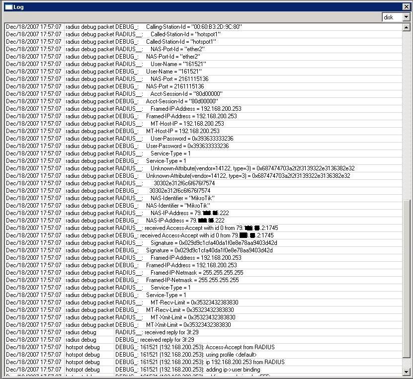

There has been picked as the logs in Router OS: ((
Therefore made screens.
Packet W2 18/12/2007 17:55:15.141
Identifier: 0
Length: 68
Authenticator: 02 9D 9C 1C FA 40 DA 1F 0E 8E 78 AA 94 03 D4 2D
Attributes:
8: 192.168.200.253 [Framed-IP-Address]
1: 5242880
2: 5242880
Source:

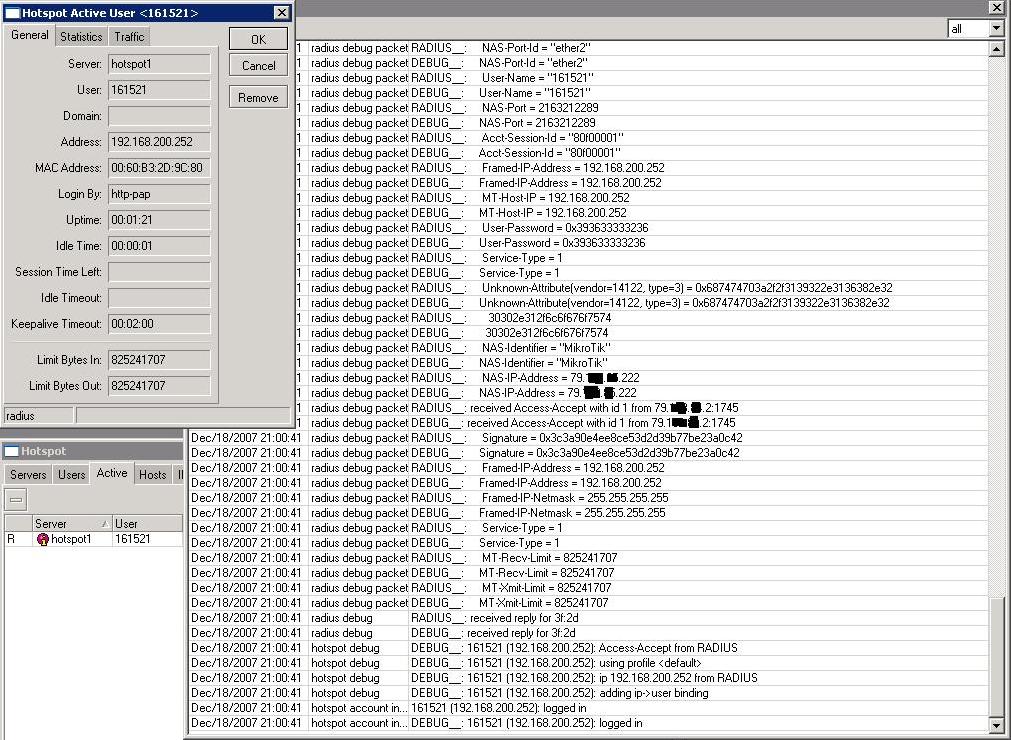

but another interesting picture.
if the parameters to convey the importance of equal 100k, which has produced:
Packet W3 18/12/2007 20:58:32.859
Identifier: 1
Length: 62
Authenticator: 3C 3A 90 E4 EE 8C E5 3D 2D 39 B7 7B E2 3A 0C 42
Attributes:
8: 192.168.200.252 [Framed-IP-Address]
1: 100k
2: 100k
Source:

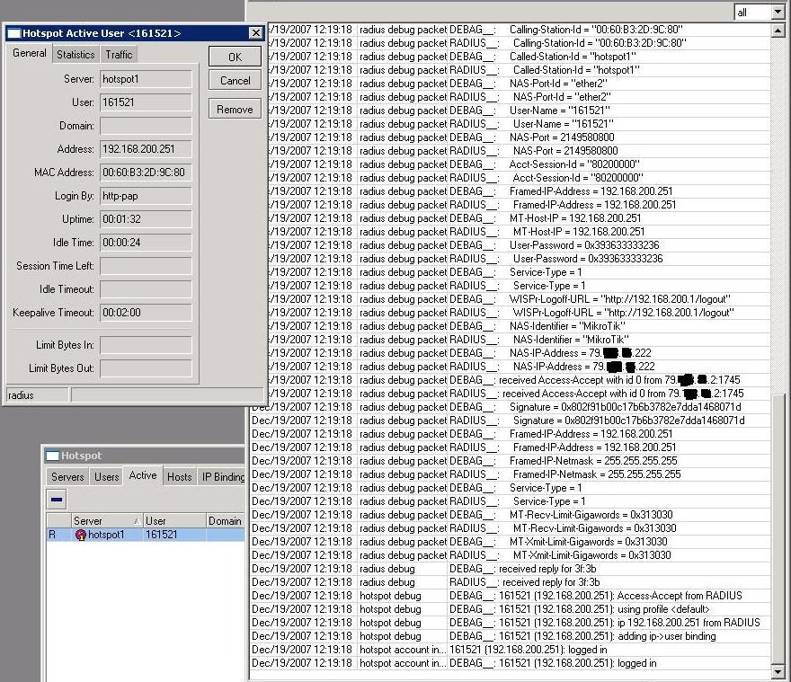

In RADIUS No problems, can be seen on the log itself RADIUS. He correctly refers to RouterOS what I said. But as it takes RouterOS-more like a bug.
Packet W2 19/12/2007 12:16:53.766
Identifier: 0
Length: 60
Authenticator: 80 2F 91 B0 0C 17 B6 B3 78 2E 7D DA 14 68 07 1D
Attributes:
8: 192.168.200.251 [Framed-IP-Address]
14: 100
15: 100
Source:
02 00 00 3C 80 2F 91 B0 0C 17 B6 B3 78 2E 7D DA
14 68 07 1D 08 06 C0 A8 C8 FB 09 06 FF FF FF FF
06 06 00 00 00 01 1A 0B 00 00 3A 8C 0E 05 31 30
30 1A 0B 00 00 3A 8C 0F 05 31 30 30

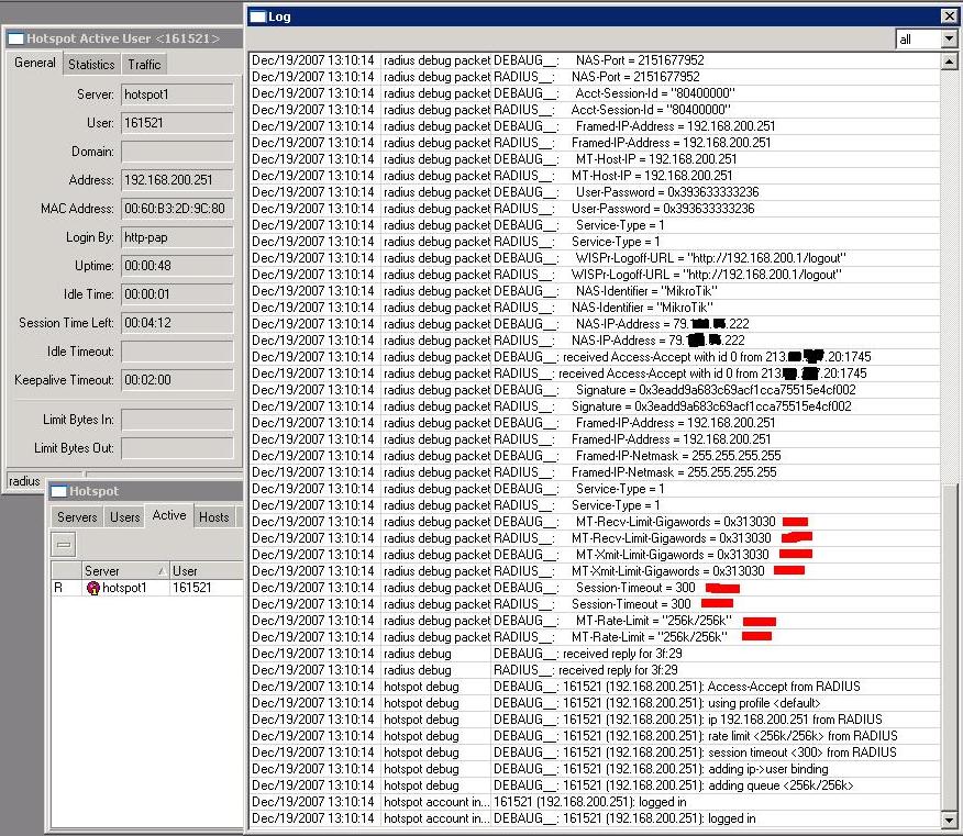

here is another picture.
in this case, refer to the RADIUS RouterOS information on the speed, time limit of the session and traffic. And that is produced data on the speed limit of time and RouterOS understood, but the traffic of limit-no!
Packet W1 19/12/2007 13:8:10.875
Identifier: 0
Length: 83
Authenticator: 3E AD D9 A6 83 C6 9A CF 1C CA 75 51 5E 4C F0 02
Attributes:
14: 100
15: 100
27: 300 [Session-Timeout]
8: 256k/256k
Source:
