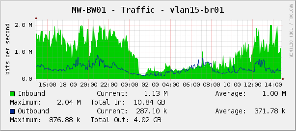

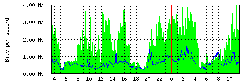

I have a monitoring box running cacti on my network. I am monitoring my Mikrotik host and it is reporting that the interface is operating at a maximum of 2Mbps. When I check the Interface Statistics on the Mikrotik its self via the web interface, I have a graph that reports double.
Via Cacti:
via Interface Statistics:
My queues have had to be implemented using a 4M limit, where the actual throughput is only 2M.
