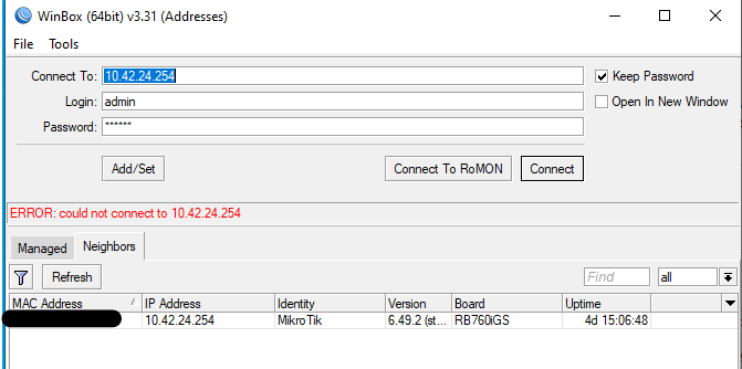

I have also tried to add a rule, to reach the LAN interface of the mikrotik router, but this problem still exist.
Connect via MAC address does still work.
[admin@MikroTik] /ip ipsec policy> add action=none src-address=10.42.24.0/24 dst-address=10.42.24.254/32

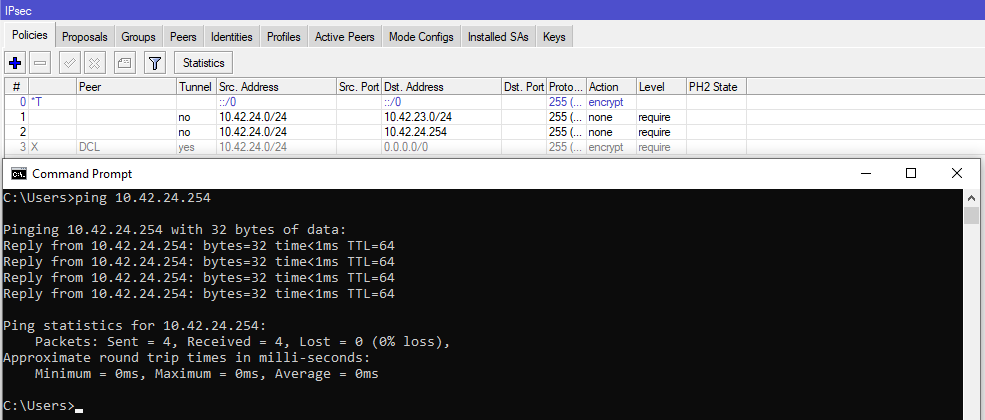

Move it up, router uses first matching policy, so order matters.
I have already moved the default rule to the bottom.
When I disable the 0.0.0.0/0 rule, I’m able to ping the router.
Sorry, my mistake, if it’s to router itself, IPSec would not touch it anyway, because it would go in input chain. Right now I don’t know, but I’ll try some test here, if something shows up (I don’t usually use tunnels with 0.0.0.0/0).
Use whole local subnet for both src-address and dst-address:
/ip ipsec policy
add action=none src-address=10.42.24.0/24 dst-address=10.42.24.0/24
Or just swapping src-address and dst-address would work too:
/ip ipsec policy
add action=none src-address=10.42.24.254 dst-address=10.42.24.0/24
It’s because IPSec policies not only tell router what to encrypt, but also what to drop, when it comes from elsewhere.
Here the source is router itself (10.42.24.254) and other device in 10.42.24.0/24 are destination, that’s what this policy looks for, and it tells router to not encrypt this traffic.
Incoming filtering is used in reverse. With your original rule, there was incoming packet from e.g. 10.42.24.100, which was checked against dst-address=10.42.24.254, and it didn’t match. So the next policy applied, which says that such packet can only come from remote peer. And it didn’t, so it was dropped.
It may be confusing at first, but it makes sense.
