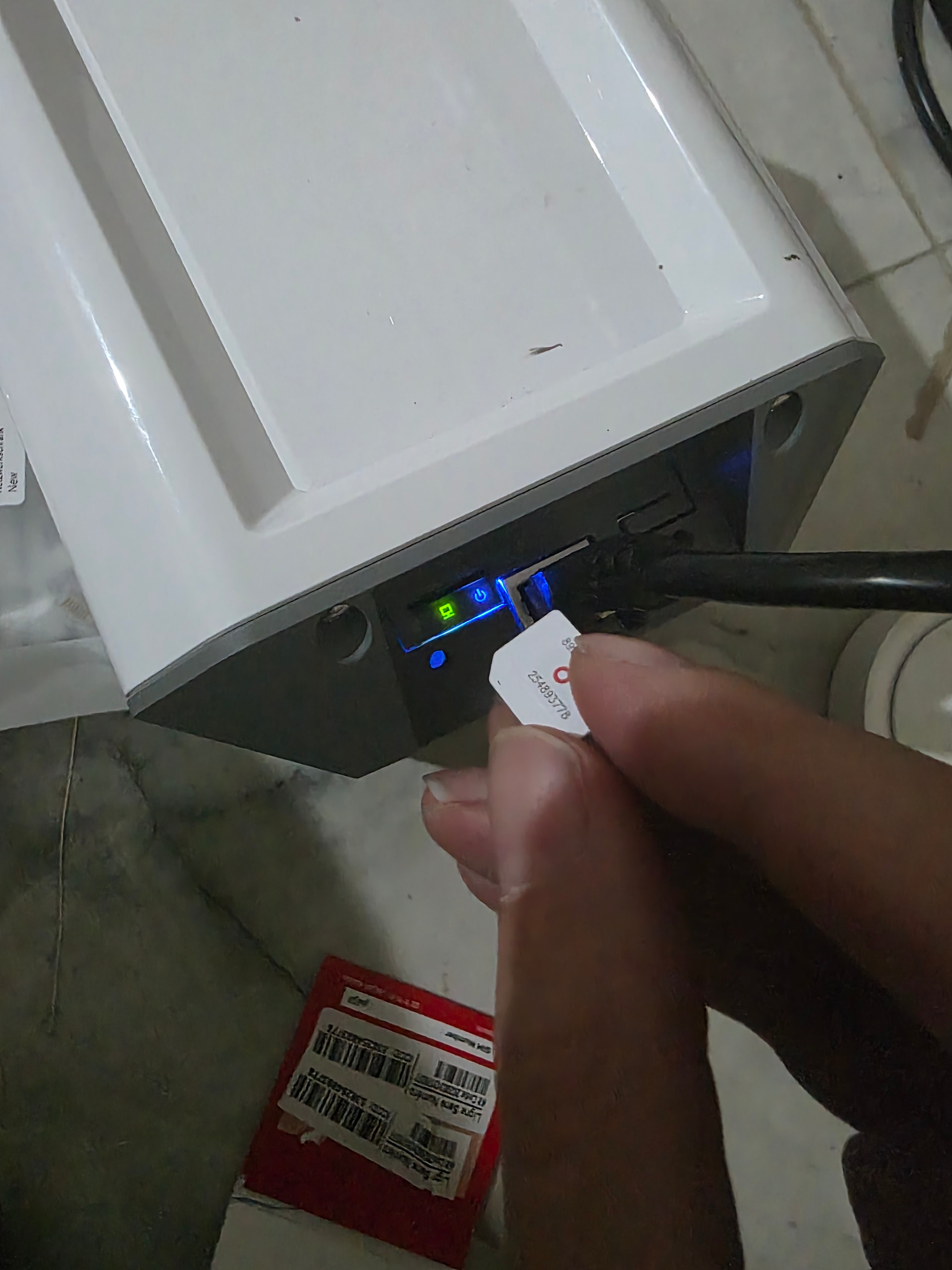

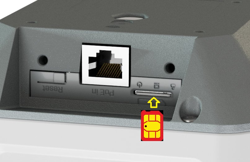

My MikroTik router is not detecting my Ooredoo SIM card. It shows as if no SIM card is inserted at all.
I have restarted the router multiple times, but it still does not recognize the SIM. I am attaching a photo of how I inserted the SIM card into the slot to verify if it is in the correct direction.
Is there a specific configuration required for Ooredoo Tunisia, or is the SIM incorrectly inserted?
Thanks for the help!

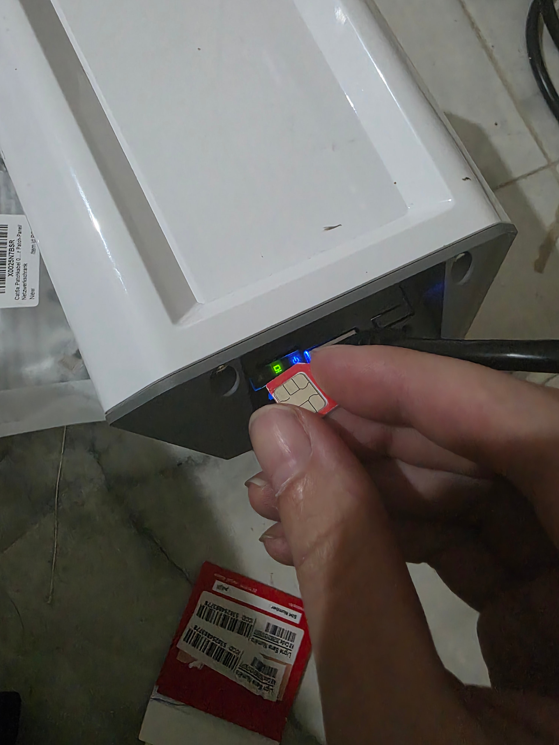

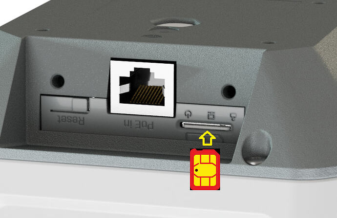

You do understand how you posted two photos where you are inserting the SIM "one way" and "upside down"? :astonished_face:
One of the two is surely "wrong" :wink:.
A SIM inserted in the "right" way should be detected, then whether it works or not it is another thing.

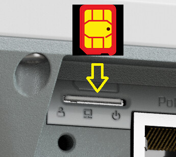

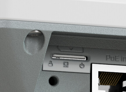

Not Chateau for sure, I have 2 of them, near SIM slot it should be drawing (on Chateaus exists) on which side cutted part of SIM must be inserted
Is a LAMP, and both are wrong.
Just follow the icon on product.

Can I see a Cap on the first pic ???
So the sim card is not inserted into a Mikrotik Router.
NO, is a "LAMP 5G R16"...
Not that the icon is actually very easy to understand.
Can we try another way?
Contacts should be on the upper or lower side?
The dent should be towards the inside or outside of the device?
And on the right or on the left?
It seems to me like it should be upper/inside/right, i.e. second photo is correct, right?

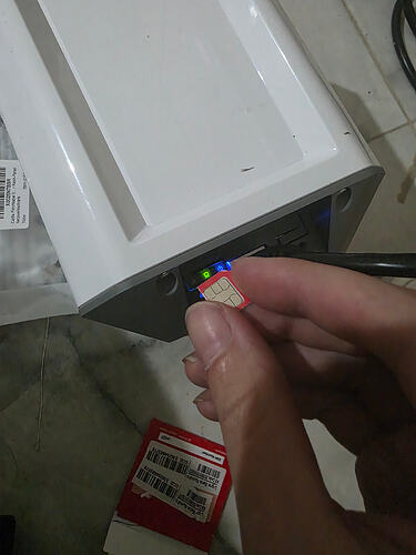

added another image to previous post...
must work if the slot is not damaged to press the SIM on wrong side...
really, is very clear, for me...
So it is the first photo that is correct.
Contacts on lower side.
Notch towards the inside and on the left.
Just like the AI generated image :rofl:

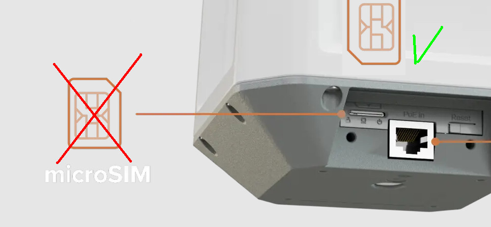

Is this more understandable? (Provided that I understood correctly)
So the "icon":
\_______|
represents the lower side of the SIM?
Well, I think my picture is pretty clear............. (the arrow...) \___V___|
That little piece you see represents the tip of the SIM card just before you insert it...
I don't think it's such a difficult "ideogram"...
Or for better "Human" way...
Now you are holding the LAMP upside down.
The Icon of on/off should have the vertical bar up, and also the
uI ƎoԀ
tells something ... :rofl:
