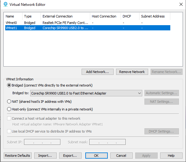

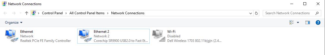

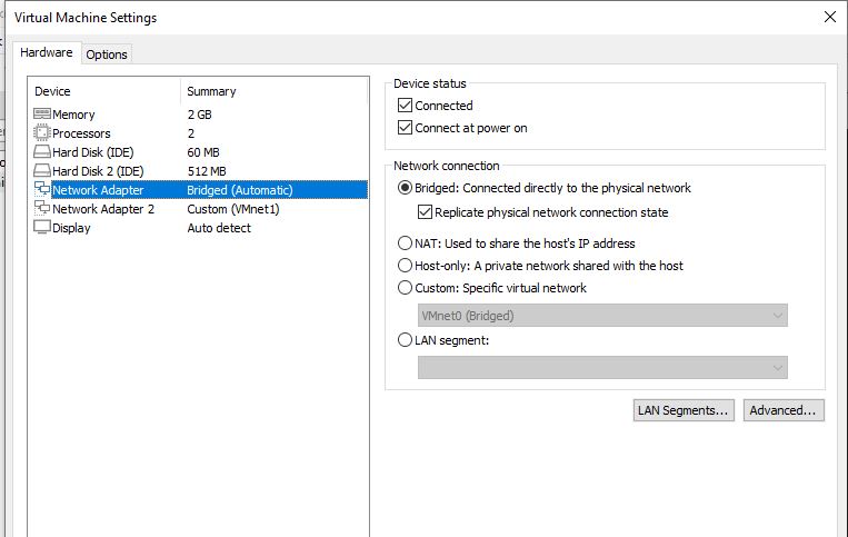

here in pic you see my setting of VMware & mikrotik vm setting and my laptop pc setting …now if i connect other pc via lan at that time in my main laptop mikrtik hotspot page is opening asking for user/pass and if i enter user/pass i am able to browse into main pc and other pc didn’t to connect internet…here mikrotik setting you can see
