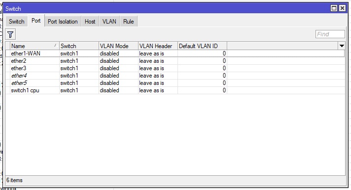

You dont need to guess topology, here it is. RB951Ui-2nD, ether1 as WAN, and ether1-ether5 in SWITCH mode togoether with switch1-cpu. On other end ( x86 device ) All ports from port0-port9 in bridge mode and cable connected to RB951Ui-2nD. I dont have SWITCH option in winbox for x86 device. Is it problem?

But you wrote ether1 is a WAN and also listed ether1 in “switch mode”; as there is no such thing as “switch mode”, better post the export of the configuration of the 951. All the ethernet interfaces of the 951 are ports of the switch chip; it depends on the bridge configuration whether traffic is forwarded among them by the switch chip itself or whether all the L2 forwarding decisions are made in the software bridge(s), i.e. by the CPU.
The fact that no switch section is shown in WinBox is no surprise as the x86 version of RouterOS doesn’t expect any switch chip to be available on a PC hardware for which it is designed. So it is not related to your issue.

There is in attachments. I scrambled my public IP with X.X.X.X because I run some services and I dont like to expose my network config, SSID and PASS. Ether1 cannot be removed from switch as you see on screenshot. Italic ports are emppty ( 4 and 5 ).

Of course, that’s what I said before, all the Ethernet interfaces are in fact ports of the switch chip, it only depends on the rest of the configuration whether the switch is allowed to forward traffic between them autonomously or whether it can only send the ingress traffic from a given port to the CPU which then eventually forwards it to another port.
The only weird thing I can see in your configuration is that /interface pppoe server server is attached to interface called which is nonexistent anywhere in the configuration. But ether1 is not a member port of the LAN bridge, unlike all the other Ethernet interfaces, so the configuration is not the reason why the frames with the x86 machine’s MAC address as source are being returned to it.
