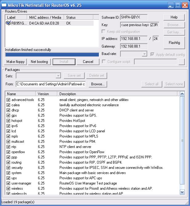

  2. I was able to download new firmware 6.25 (and previous version also) with different modules - but board also unreachable as in 1 point.

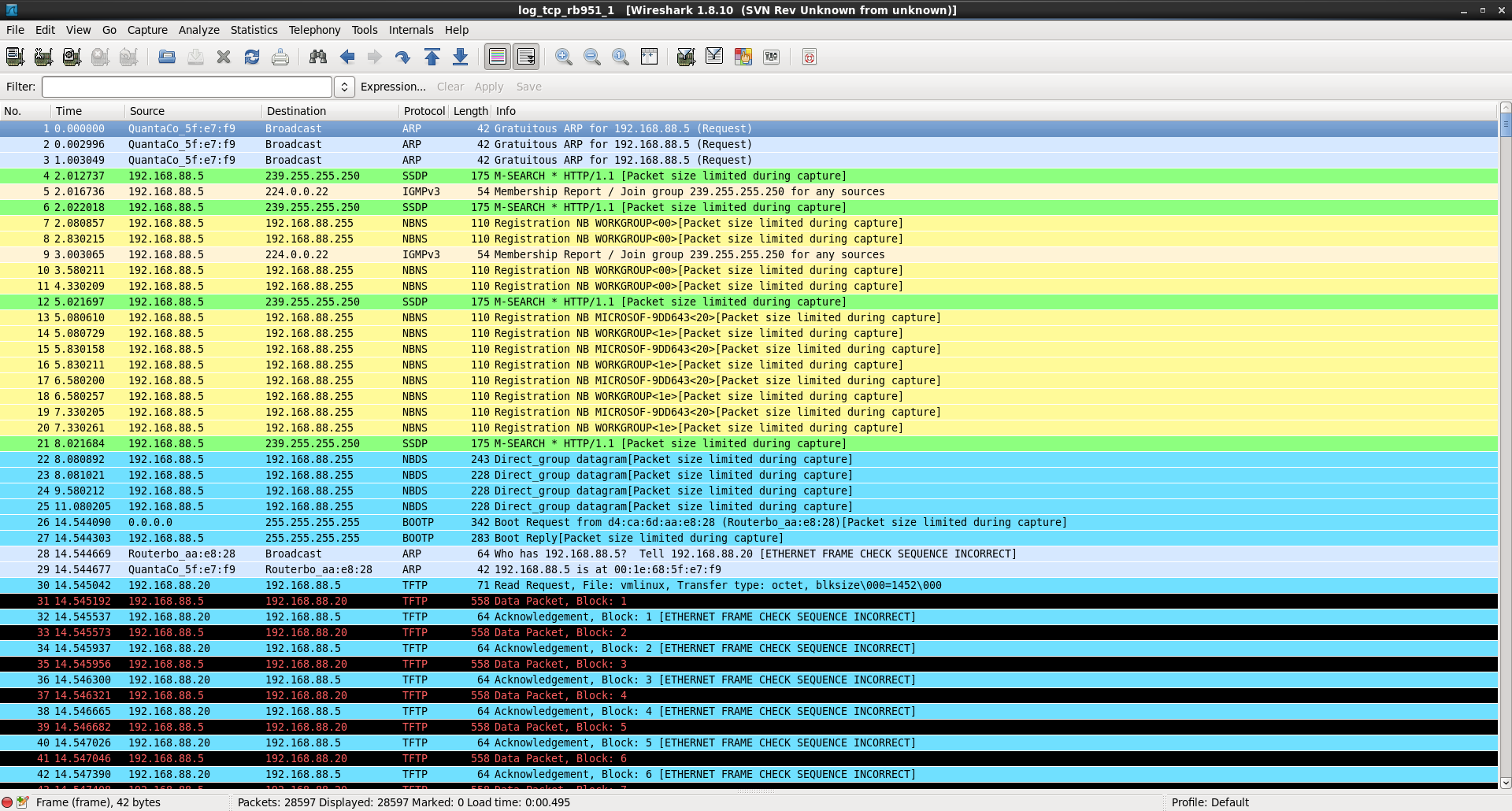

upd
I make with tcpdump a log file during firmware recovery by netinstall
here is start
and this is end
full log file
