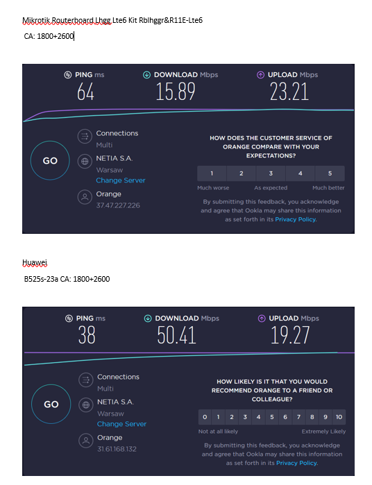

I’m struggling with new Mikrotik Routerboard Lhgg Lte6 Kit Rblhggr&R11E-Lte6- external antenna with LTE. At the beginning i was thinking it’s operator’s bts problem but it isn’t. The probles is very low download speed with this antenna mounted outside of the house a bit above top of the roof. What i did a bought another sim card of the same operator and i placed it in Huawei b525 router inside of the House. Then i forced mikrotik to use CA 1800+ 2600 and Huawei to use CA 1800+2600 with HManager and i did speed test. Does any1 have any idea why Mikrotik mounted externally has much lower download speed then Huawei b525 + LTE external antenna all inside of the house ?
There was the same problem with sim card of different LTE so it looks like this is Mikrotik problem.
I will attach screenshots with both speed tests.
If you have any ideas please let me know - maybe i should return this antenna to to shop as fast as possible.

It pickups wrong towers? LHG is very directional - I have problem in river valley with constantly switching to signal which is reflects/bounces from opposite side. Did you use Cell Monitor and Cell Lock?
