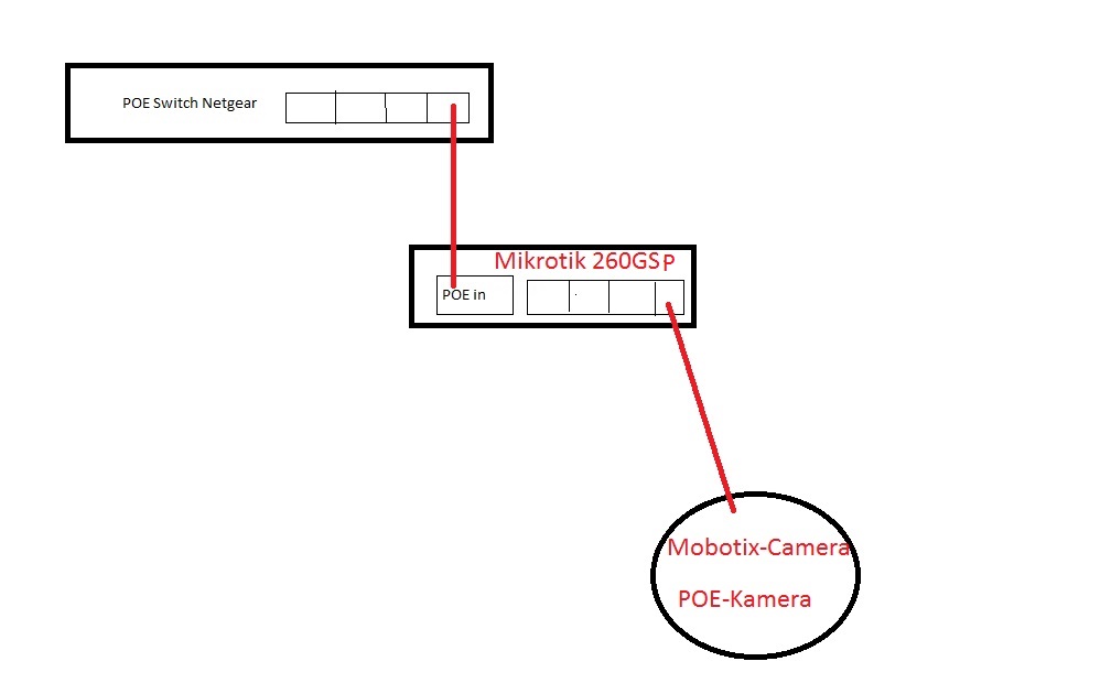

I test RB260GSP with Mobotixcamera, but I don`t find a solution to use only RB260GSP with Mobotix.
  1. I want use RB260GSP with one Mobotixcamera - dont work
  2. so I use RB260GSP with Netgear-POE-Switch - dont work, too (look screenshot)
  3. The Netgear Switch alone works fine
260gsp is not 802.3af
What can I do with POE-Port on 260gsp?
You can power all kinds of Mikrotik and Ubiquity gears (Aircams work)…
the mAP works with mobotix if you give it 48VDC,
