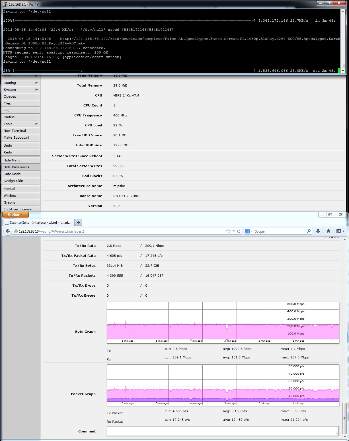

So here is the Answer for People which came after me.
I installed the 2Ghz Hardware with gigabit port RB SXT G-2HnD in bridged mode.
The Link speed is pending between 190mbit and 205mbit using wget, single tcp thread.
On each side is an TpLink WDR4900 installed with openwrt trunk doing the Routing stuff.
I think there could be more than that but the CPU inside the RB is hitting its limits. Maybe someone has an idea to decrease
this??
I atached a screenshot here. Maybe its helpful for someone…
