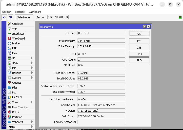

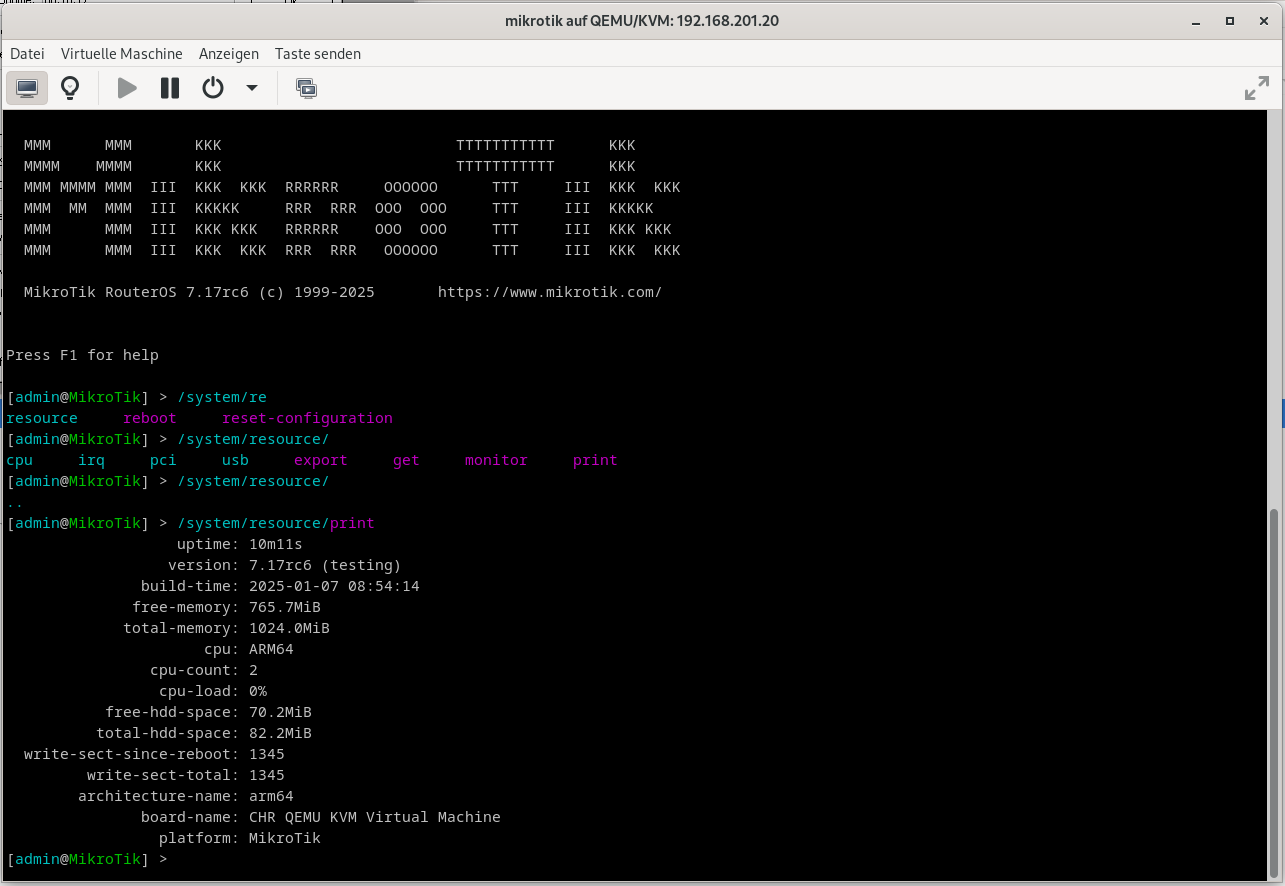

You can run RouterOS on the r4 in a virtual machine, I tried it with the Cloud Hosted Router image from downloads, I took the “Raw disk image (arm64)” and it’s working fine. I tuned my bpi-r4 a bit to get hardware acceleration with kvm and installed libvirt to manage it with virt-manager from my desktop. But you will never get 10gbit routing speed with this combination.
