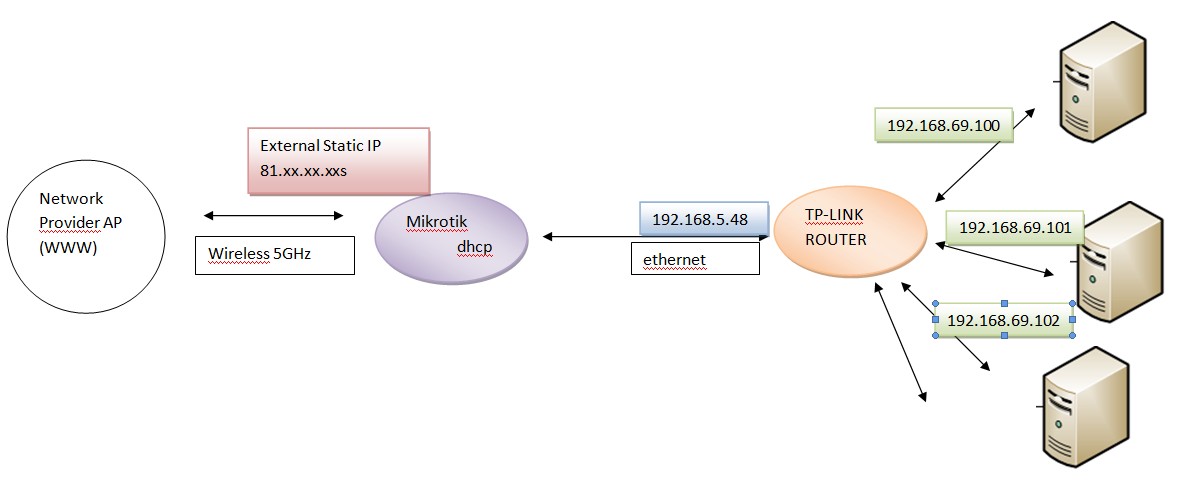

Here is my network topology:

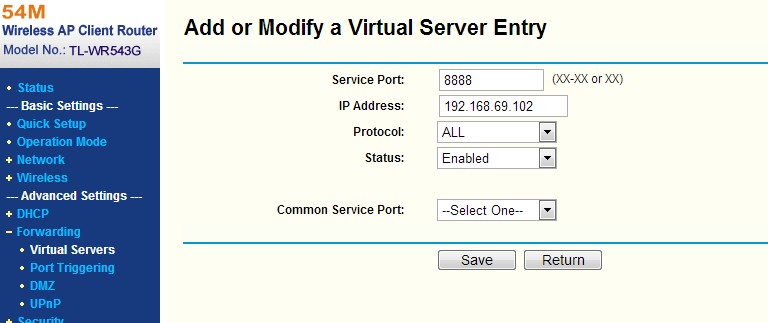

I have a problem with port forwarding. For example:
I want to access from Internet via 81.xx.xx.xx:8888 to 192.168.69.102:8888.
Im using software Yawcam to get webcam view form my local network. It works fine in local network. I can access by 192.168.69.102:8888, or 192.168.5.48:8888, so port forwarding in tp-link is correct.

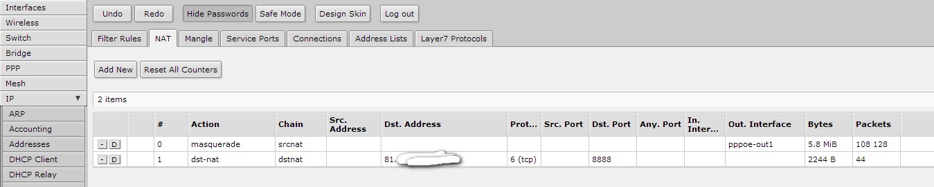

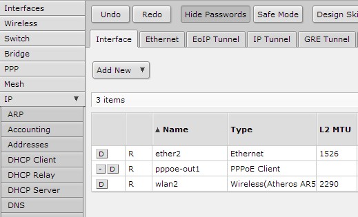

Here’s my configuration:

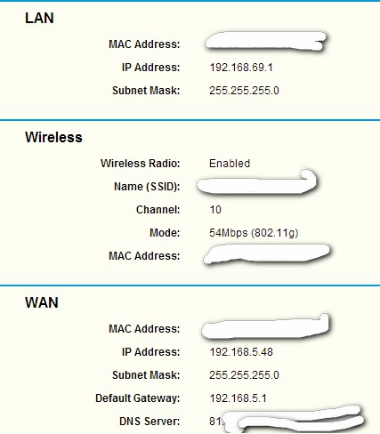

Ofcourse i forward from 81.xx.xx.xx:8888 to 192.168.5.48:8888 over tcp (mikrotik configuration). Here is tp-link configuration.
The graphics don’t actually show all the relevant information.
Try uploading the output from /export compact instead.
Problem solved.
I had to add masquerade srcnat chain for 192.168.5.0/24 for wlan2. and 192.168.5.48 for ether2. I have no idea how, but it works.
Probalby 192.168.5.48 wasn’t in NAT earlier.
