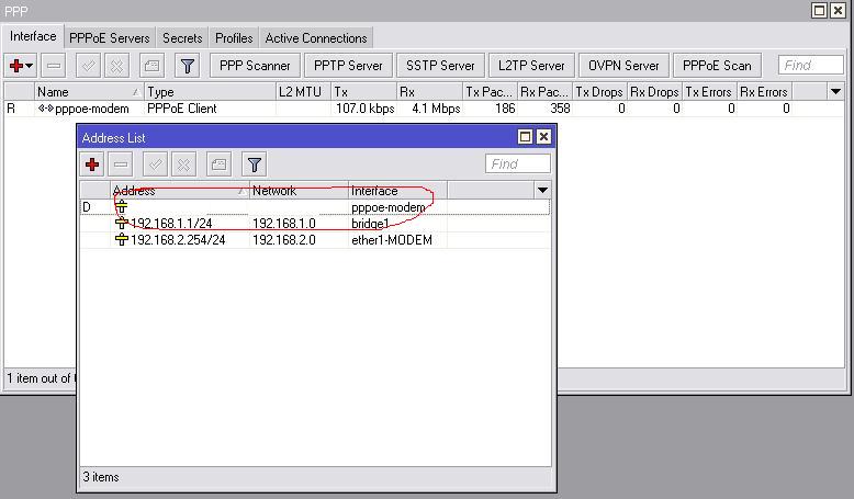

My Mikrotik ROS version 3.30, I have a PPP0e internet connection, that is show dynamic ip and it have changed after some hour. I want Mikrotik ROS send me current/connected IP address by email after some hour. Is it possible, If so please give me details how to possible it.

If your mikrotik router makes the pppoe connection, you should add a script like this:
:local ipadd [/ip address get [find interface=pppoe-modem  ] address ];
:local msg (" My ip is: $ipadd");
/tool e-mail send to="email@gmail.com" subject="My Ip" body=$msg  server=[:resolve smtp.gmail.com] tls=yes;
