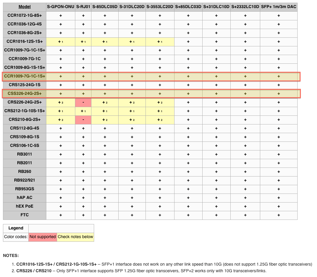

According to the wiki a 10G Link between CRS326 and CCR1009-7G-1C-1S+ using a SFP+ 1m or 3m DAC should be supported (SFP+ 1m/3m DAC column):
I would check both Routerboards have the latest ROS / SwOS versions and Firmware, if you still don’t get a 10G link, I’d generate a supout and email it to support, linking to this post.
