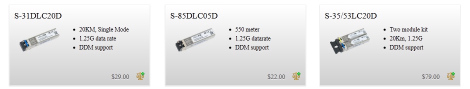

Mikrotik SFP modules
PDF - http://routerboard.com/pdf/463/SFP.pdf
S-85DLC05D is ethernet 1000BASE-SX?

We plugged the 1310nm Version in a linksys switch and got high packet loss at some times. So there are compatibility issues. We used Levelone SFPs before which did not show this issues. We did not see this with MT SFP in Routerboard and Levelone SFP in Routerboard.
Deleted because not related.
We’re only using 1310nm on all fiber links to avoid compatibility problems. Dont like the situation where I am
at a tower with the wrong module.
Not seen issues between a MT SFP in a Routerboard to a LevelOne SFP in a routerboard. So it’s not a problem of
the link signal/protocol. It is an issue between Linksysswitch and RB SFP.
Yes. Indeed. And they are quite cheap. So using them in Routerboards is a good idea. But be warned using them in other switches you might see issues.

I have no Linksys SFP I have LevelOne. Yes. This should work fine. I guess as I often see “Cisco compatible SFP modules” that not all SFP Modules work in every switch without problems.
As there are different fibre cables too components have to be selected carefully. We only use 1310nm components to reduce this issues.
can be this using in the cisco router???
