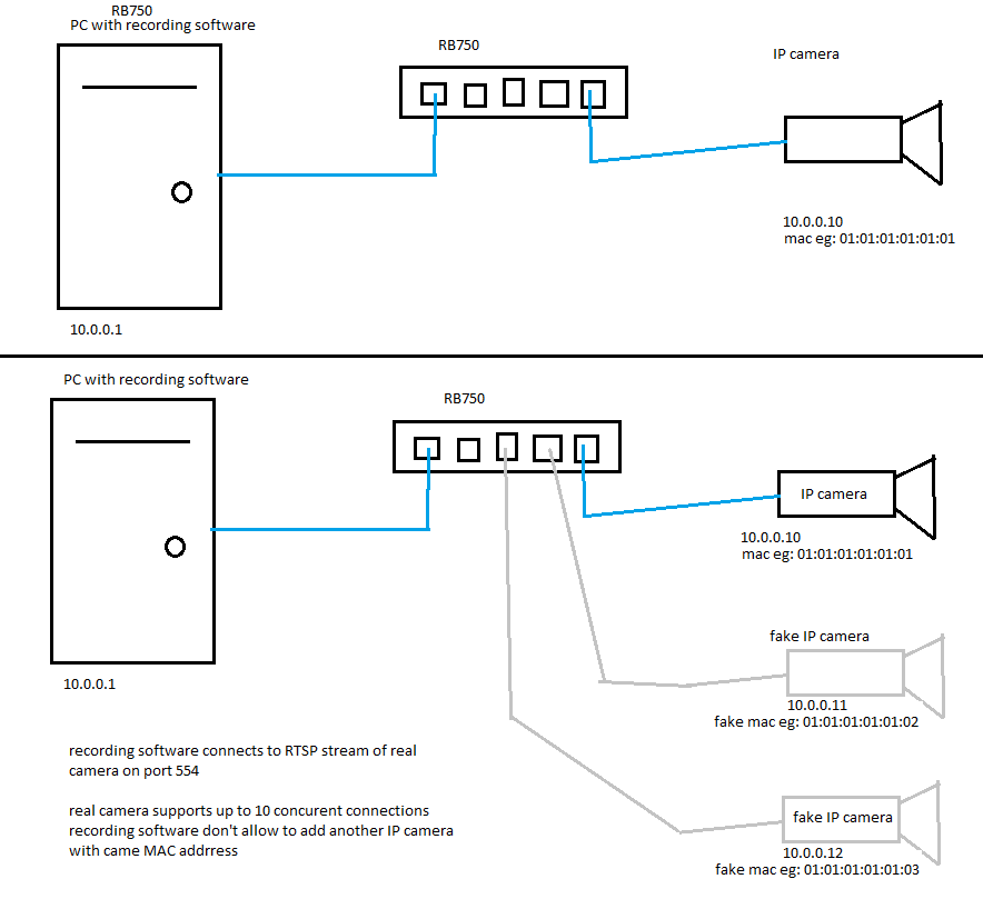

I have to do stress test of some recording software and some hardware NVRs. I do not want to and not really can setup 32 IP cameras just for this.
I would like to setup one RB750 between recording device and real camera. I need to setup mikrotik to behave like 32 ethernet interfaces (32 unique MAC addresses) each one with unique IP. If NVR tries to connect to one of them by TCP on port 554, mikrotik have to forward connection to one real IP camera, without NVR to notice this. So NVR would record 32times same stream. PC recording software and NVRs demands one IP with one MAC address per channel and not allowing to add more IP’s with same MAC.
I tried something but failed. This is really unusual scenario, but I belive Mikrotik can do this. Please point me what I need to configure.

Thank you for your reply. You are absolutely right about proper switch for 32 cameras. We are using them on real installations. I really can nott take 32 cameras just for this lab setup. We have about 7 different IP cameras in stock as replacement for various installations. Camera distributors we are cooperating with can borrow us 1 or 2 for testing, but not 32 :slight_smile: This is why I want this synthetic setup.
My little Mikrotik do not have to simulate 32 cameras, but as much as it can.
