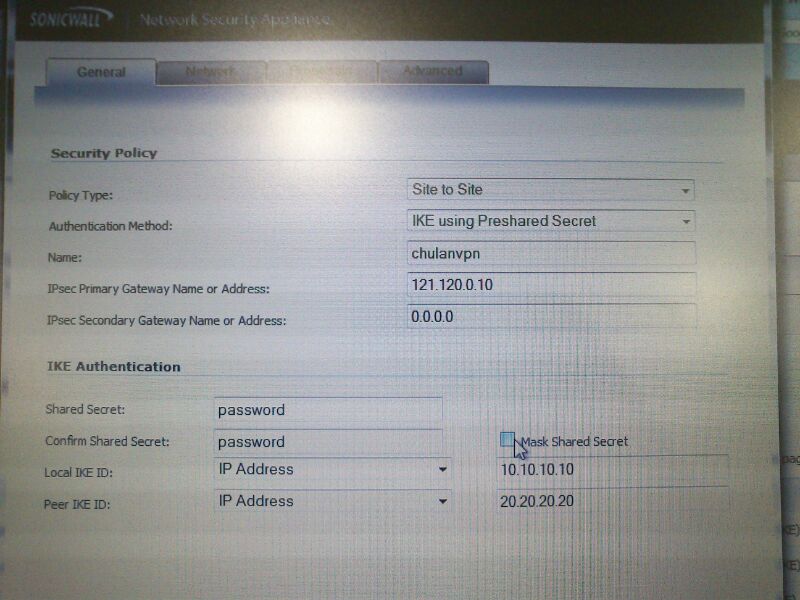

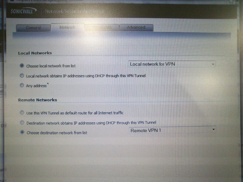

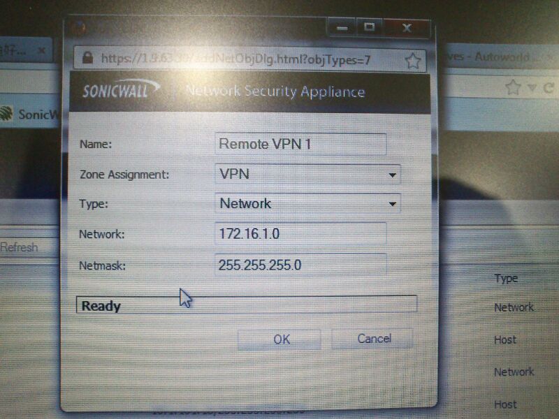

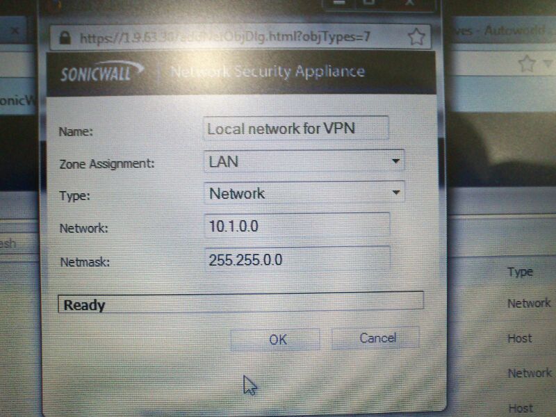

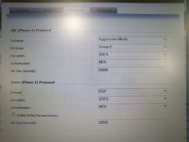

Hi…i manage to get MT to VPN to SW using IPsec site to site a couple of weeks ago.
The SW config i used is as follows
As for MT…follow the wiki and use FQDN (in the form of email address, fictitious is fine) as the secret for SW.
There are 2 more pics of the SW config, but am unable to upload.
2 more pics of the SW config.

in-interface=ppp-out1 protocol=udp
add action=accept chain=input connection-state=new disabled=no dst-port=4500
add action=accept chain=srcnat disabled=no dst-address=10.1.0.0/16
src-address=172.16.1.0/24
add action=masquerade chain=srcnat comment="default configuration" disabled=
no out-interface=ppp-out1
/ip firewall service-port
set ftp disabled=no ports=21
set tftp disabled=no ports=69
set irc disabled=no ports=6667
set h323 disabled=no
set sip disabled=no ports=5060,5061 sip-direct-media=yes
set pptp disabled=no
/ip hotspot service-port
/ip ipsec peer
add address=1.9.63.30/32 auth-method=pre-shared-key dh-group=modp1024
disabled=no dpd-interval=disable-dpd dpd-maximum-failures=1
enc-algorithm=3des exchange-mode=aggressive generate-policy=no
hash-algorithm=md5 lifebytes=0 lifetime=8h my-id-user-fqdn=
ivanlim.digi@gmail.com nat-traversal=yes port=500 proposal-check=obey
secret=password send-initial-contact=yes
/ip ipsec policy
add action=encrypt disabled=no dst-address=10.1.0.0/16 dst-port=any
ipsec-protocols=esp level=require priority=0 proposal=ITIS_Proposal
protocol=all sa-dst-address=1.9.63.30 sa-src-address=10.72.253.11
src-address=172.16.1.0/24 src-port=any tunnel=yes

Can anyone here help me with this post IPSec VPN ?
