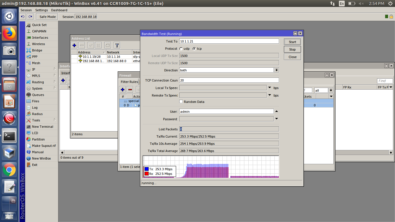

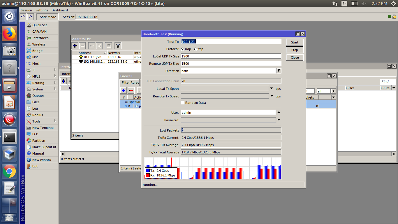

I have CCR1009-7G-1C-1S+ and CCR-1036 and connect using 10G sfp + modules and fiber connection, when I see bandwidth test results 1836Meg /2.4 Gig UDP and 252.5/253.3 Megs TCP.

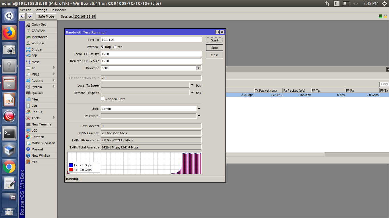

Now I created vlans and I got 277.8/282.4 Megs TCP and 2.0/2.1 Gig UDP. I was expecting at least 5 gig on fiber and I am using Multi mode modules.

Bandwidth test tool is useless for SFP+. won’t reach more than 2Gb ever.
Use iperf and two PCs…
